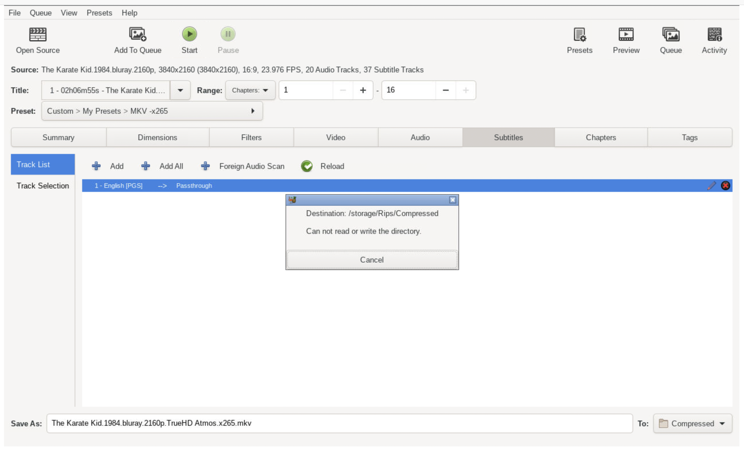

Hi, getting an error "Can not read or write the directory.". Anything I should try? Tried restarting/start/stopping the docker and no luck there.  Not sure where to go from here.
Where and how are you getting this error ?
In the docker itself when I try to Start Encoding a movie.
By default /storage is read-only.  You normally have to write encoded files to /output in the container.
Okay, good to know thanks! Set it to the output directory and that's working as expected.
