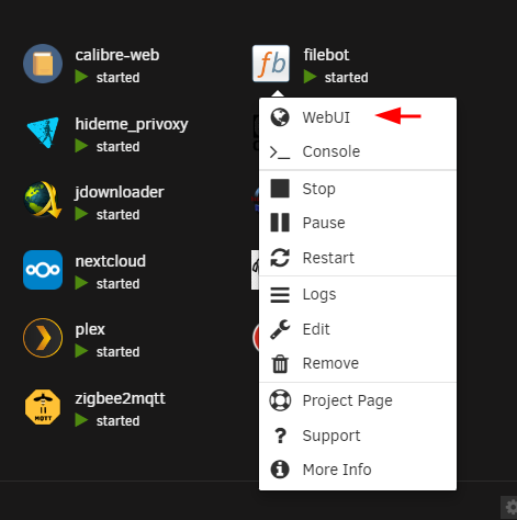

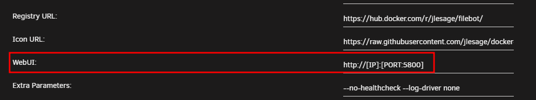

Did anyone lose access to the GUI to do manual encodes?   the top option is now console which speaks for itself.  Autoconverting still seems to work...
Actually I can access via manually inputting.  It just doesn't come up in context menu *shrug*
Edited by cbr600ds2
assuming you mean the "link from clicking the Docker icon" is gone ...
may take a look if this is still filled in your docker setting from handbrake (of course with handbrake value)
thats what is creating the link ...
Thanks!  I'll have to check after my data rebuild.  I did see it was pointing to a different port than what I have mine at so I'm pretty sure that's it.
