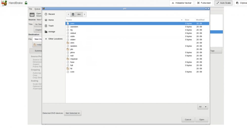

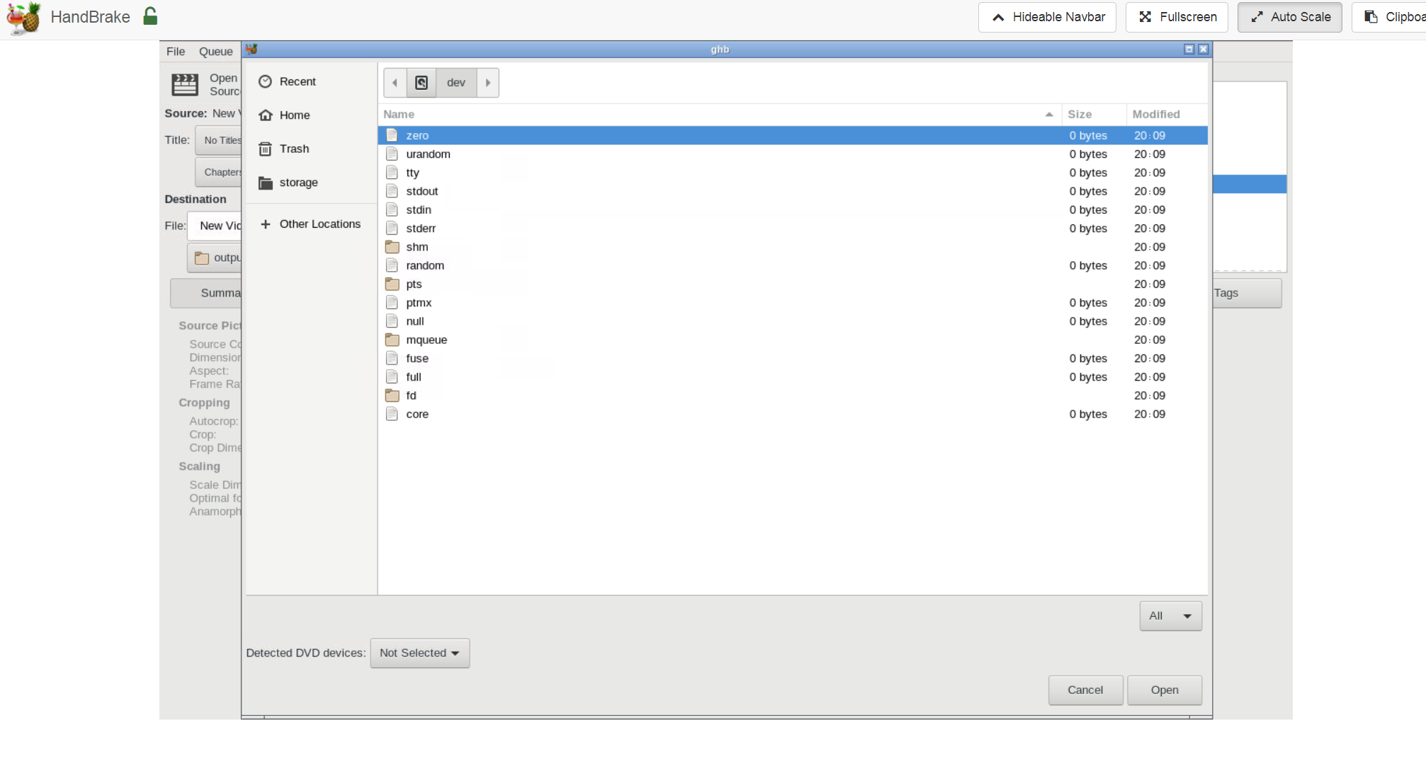

Updated, but didn't see my sata drive. Also tried the same additional option like we use in makemkv, also no bueno. I assume it's something different we need to do?
Open you click the "Open Source" button, you need browse and select the Linux device of your optical drive (e.g. /dev/sr0).
I give, am I just not seeing /dev/sr1 ?
Did you added the —device /dev/sr1 parameter?
Also, look at the container’s log, there are some messages about detected drives.
No, I removed that parameter before updating. Is that what I'm missing? If so, I feel silly. New to docker, I am getting the feeling that the standard docker layout is universal for all containers, and that parameter is needed to pass a devices through. Yep, let me test that :-)
Edited by cybrnook
Alright got it. I see after a reboot my server went to /dev/sr0, problem #1 :-)
And damn, you even added a nice little note in your docker explaining how to add an optional drive. Needless to say, I got it. Thank you for adding this!!
