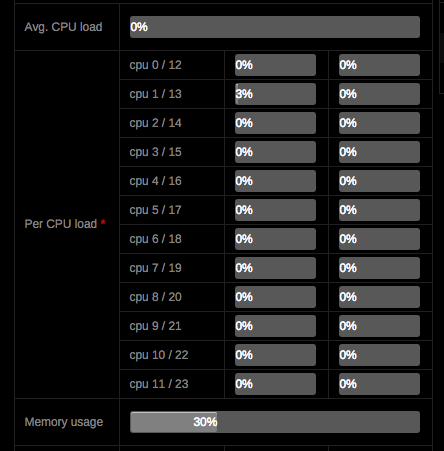

Also, here is a screenshot of one of my servers with 3 vm's currently running on threads 6-23, with threads 0-5 isolated for only unraid/dockers. Sleep is disabled on all vm's.

6 threads only used by unraid. Rest for vm's. all 3 vm's use an emulator pin set to use one of the 6 unraid threads. 2 use vnc, 1 uses gpu. If you leave vnc connected, it will never idle at next to nothing because the vnc needs CPU power to process. I set each of the vm's to allow thier "monitor" to sleep and disable screen saver (otherwise it is using CPU to run a screensaver on a closed vnc connection- a waste.

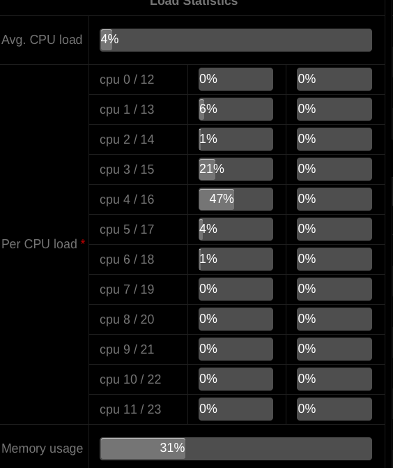

Here is another server running 2 vm's (one OS X, one pfSense-firewall/router for the network) and the following dockers: DuckDNS, Plex, Krusader, NetData.
5922f67a0f6bd_ScreenShot2017-05-22at10_31_20AM.png.8ad24f69c16c524477e2ba05e05564ee.png
Threads 0-3 are isolated for unRaid and dockers. OS X is on threads 6-9, and pfSense is 4-5. Both vm's use emulator pin 1.
Total usage shows 4%. If I were to minimize that down to your 8 cores, then my total usage would be 12% with what is currently active on my server. Take away the pfSense vm and that number would probably be cut in half with your core count.
I wouldn't expect for you to hit a consistent 0 utilization since you still have to have some resources used to manage the vm, even when it is doing nothing but running the OS clock and other background tasks. And that number will only get bigger with the fewer cores your have.
