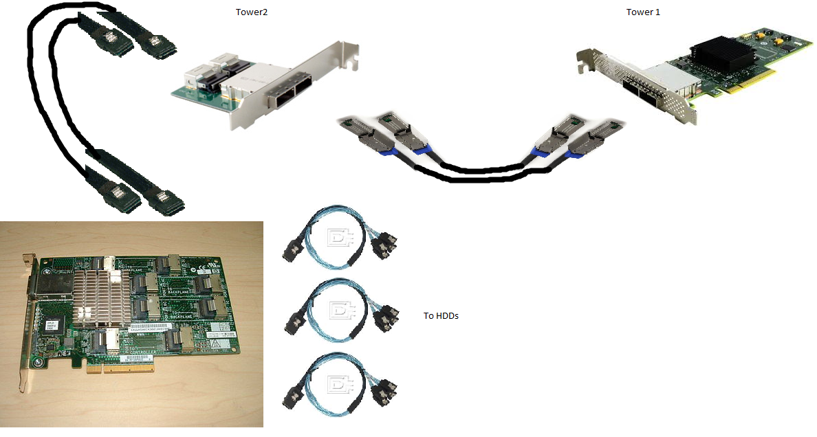

You would need an HBA in your micro server that has an external port, then a cable that goes from that external port to a breakout cable that connects to the all the backplane ports of the DS380, assuming something like this exists. You would need some method of presenting the drives in the DS380 to your HP Microserver and I don't think eSATA is the way.
Much better performance (and signaling) using a HBA with one or two external SAS ports and then run a external SAS cable to the other case and finally forward breakout cables to the disks, each external SAS port can connect 4 disks (more with an expander).

I posted this recently on another thread, you don't need the expander with 4 to 8 disks on the second case, HBA is an LSI 9200-8e, available on ebay starting from 50 or 60$.

They should be all the same, I usually prefer to buy an used server pull instead of a new one from China, as these can sometimes be fakes.
Also keep in mind that without the expander you'll be limited to SATA cable lengths, max is 1 meter, best option is to get 1 or 2 of these cables depending on how many disk you'll have, 1 meter is enough to connect from the back of one case, go through the back of the other and to the disks:
