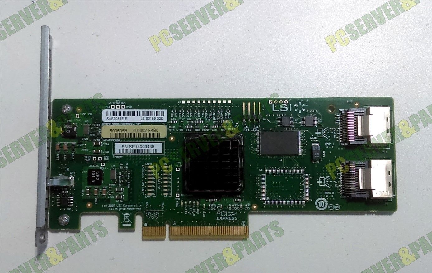

What do you think about this one? How do you know if it can support over 2TB hard drives?
Thanks.
PRODUCT DESCRIPTION
LSI MegaRAID Storage Controller
PCI Express Low Profile Interface w/ 3Gb/s Transfer Speed
Controller SAS3081E-R
path4591.pngSpecifications
Model SAS3081E-R
Internal Port(s) 36 Pin Dual Mini SAS
Host Bus PCIe x8
Manufacturer Cisco
Battery Included(YES/NO) No
Interface SATA 3GB SAS
Data Transfer Rate 300MBps
RAID Level Supported RAID 0, JBOD, RAID 1, RAID 10E, RAID 1E
Board Form Factor Low Profile MD2 Card
Supported Devices Disk Array, Hard Drive
Channel Quantity 8
OS Required Microsoft Windows 2000 / XP, Microsoft Windows Server 2003, Novell NetWare, Red Hat Linux 3.0, SuSe Linux, SunSoft Solaris 2.6 - 2.10 Microsoft Windows Server 2008 x64 Edition, VMware ESX 4.1, VMware ESXi 4.1, VMware ESXi 5.0, VMware ESXi 5.1, Microsoft Windows Server 2008 x86 Edition, Red Hat Enterprise Linux 5 for x86, Red Hat Enterprise Linux 5 x64 Edition, Red Hat Enterprise Linux 6, SuSE Linux Enterprise Server 10 for x86, SuSE Linux Enterprise Server 10 x64 Edition, SuSE Linux Enterprise Server 11 for x86, SuSE Linux Enterprise Server 11 x64 Edition

What do you think about this one? LSI SAS3081E-R 8-port Internal SATA/SAS 3Gb/s RAID Controller Card
Its $10 on ebay.
Thanks.
Check the wiki, there is a list of controllers known to work with unRAID. (see my sig)
You want a SAS2 LSI or you'll be limited to 2TB disks, that's why it only costs 10$.
Look at the IBM M1015, LSI 9201-8I, LSI 9201-16e. Last one is a huge bargain but requires you to route external cables into the case for internal drives. The internal 16 drive version is much more expensive.
