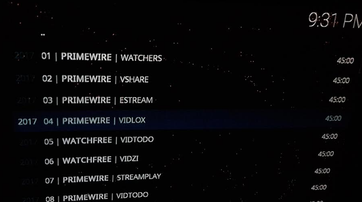

I believe the root cause of my issues is high DPC latency. I've followed all performance related steps and have cut down my latency quite significantly but I'm still having these issues with my passthrough VMs:
LibreElec: Pink/whitish pixelation, most noticable when TV is dimmed (idle state). Performance wise the VM seems to be OK but this pixelation can pop up during media playback. Source material doesn't seem to matter, it can be from an Exodus stream or from one of my MKV/M2TS Bluray files. Please refer to the attached image to get an idea of this pixelation I'm referring to. I've enabled MSI interrupts FYI. Also keep in mind this is a custom VM not the Limetech provided LibreElec template.

Any thoughts guys? I think I've narrowed my LibreElec VM issue... doesn't appear to be latency related but moreso a refresh rate problem between my AVR and my plasma TV (older 1080p unit). I dropped the refresh rate down to 30fps in Kodi system settings and no more pixelation. If I connect my HDMI cable straight from my 1050 to the TV, no pixelation though. Anyway, I have a new 4k screen coming so I suspect I won't have this issue soon enough. This AVR is geared towards an 4k display so I'm hoping that takes care of this one. I'll consider this one resolved for the time being.

The snow you are seeing in the libreelec VM is a HDMI cable problem most likely. Replace it with a good quality cable and if you are using 4k resolution be sure it handles 18Gbps bandwidth.

With regards to the cable, I was thinking that was the problem as well but I troubleshot that awhile back. If I connect the HDMI cable directly to my GTX 1050, I have no issues. If it's connected to my AVR which is then connected to my 1050, I see the issue. This is a newer/modern AVR which supports 4K and Dolby Atmos. I haven't had any issues with it until this... I'm going to wait and see if the issue is totally resolved once I get my new display installed. I suspect it's more TV end (refresh rate incompatibility) then anything else. Everything else connected to the AVR appears to work properly.
I made sure I bought a good in-wall HDMI cable, it's defined as an HDMI 2.0b cable and supports 18Gbps bandwidth.
