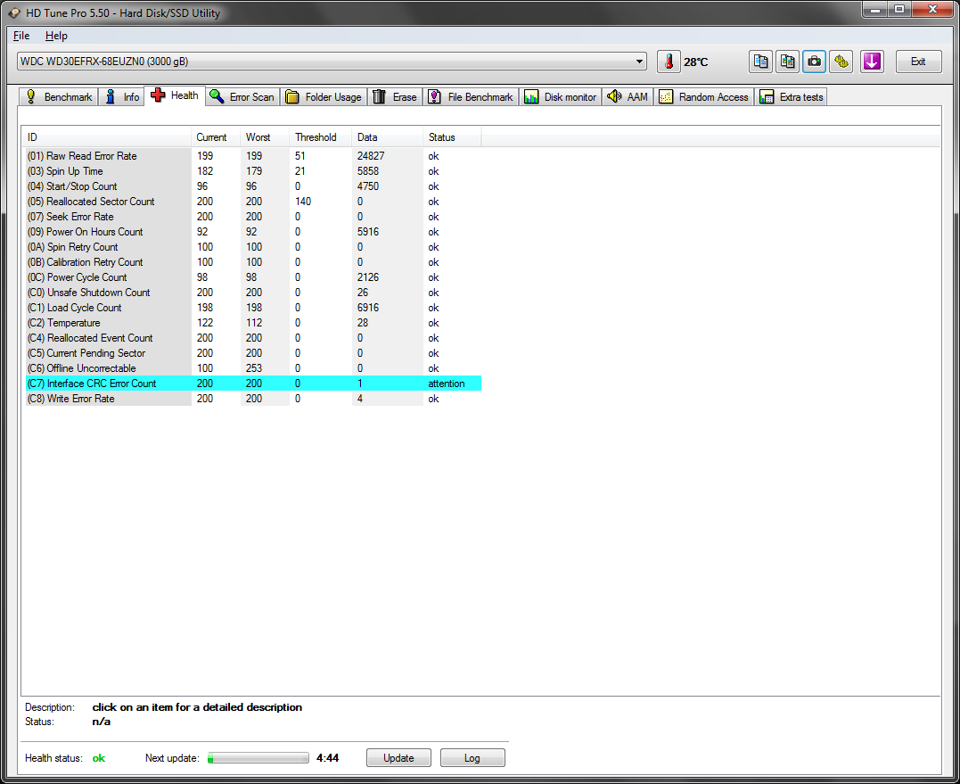

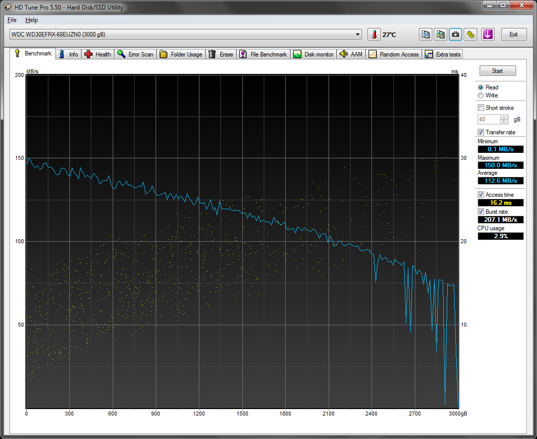

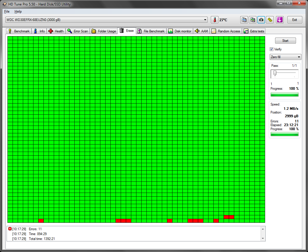

Raw Read Errors cant be fine...
One of my WD-RED has lots of them since two weeks. I checked it outside the Arry and found out, that the transfer rate is about 1,2 MB/s at this position.
The Disk has 11 Block-Errors so thats not fine and not normal.

Yes that might be possible. This WD-RED is my first failing RED - and i use plenty of this type.
Over the last 17 years i saw dying drives from IBM and - of course - Seagate, but only "one" WD.
All my sorted out WD-Greens are still working well, but this "RED-failure" tells me, that the quality of WD goes down,
so yes, if i have the money, i would prefere HGST too.
