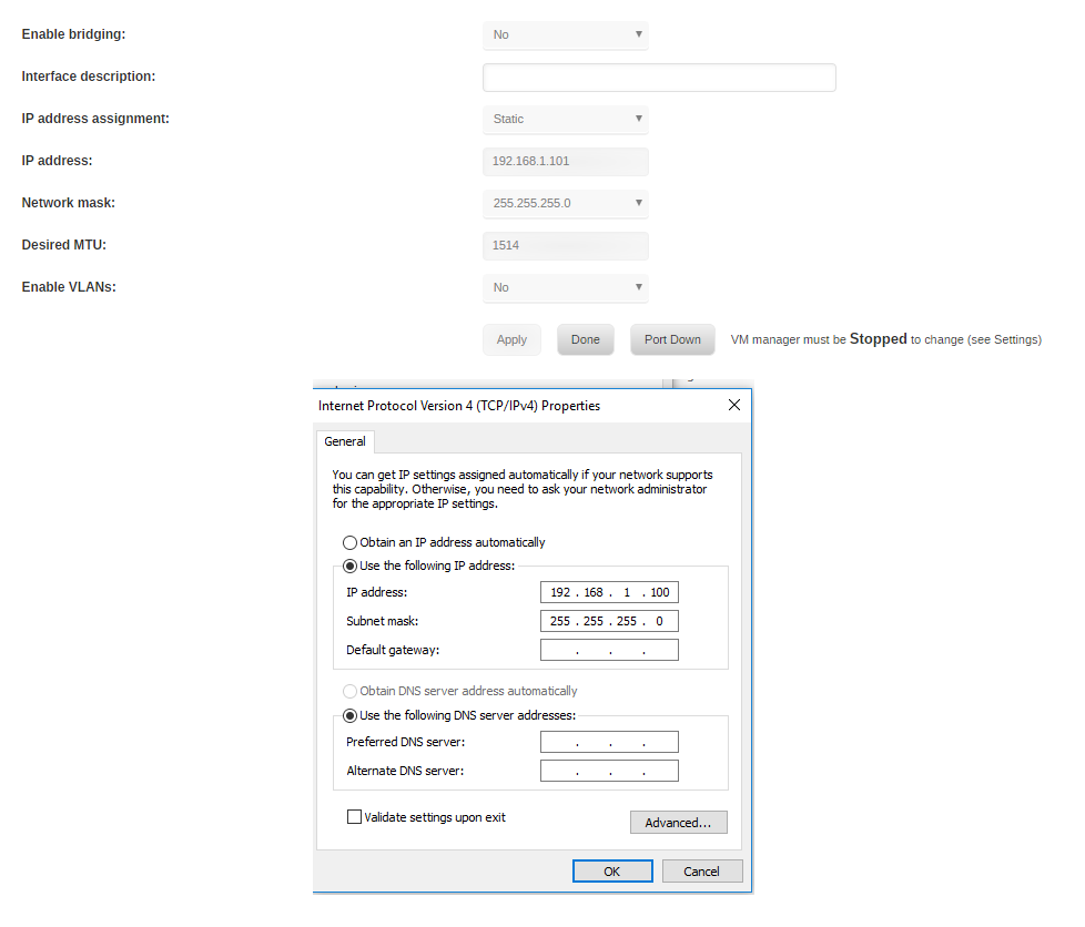

Here's my windows/unRAID settings for the direction connection... everything seem right?
You should enable jumbo frames for better performance, but that won't have nothing to do with your issues.
I actually just disabled them to test if that was why it was happening :)
