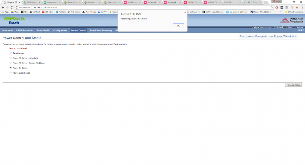

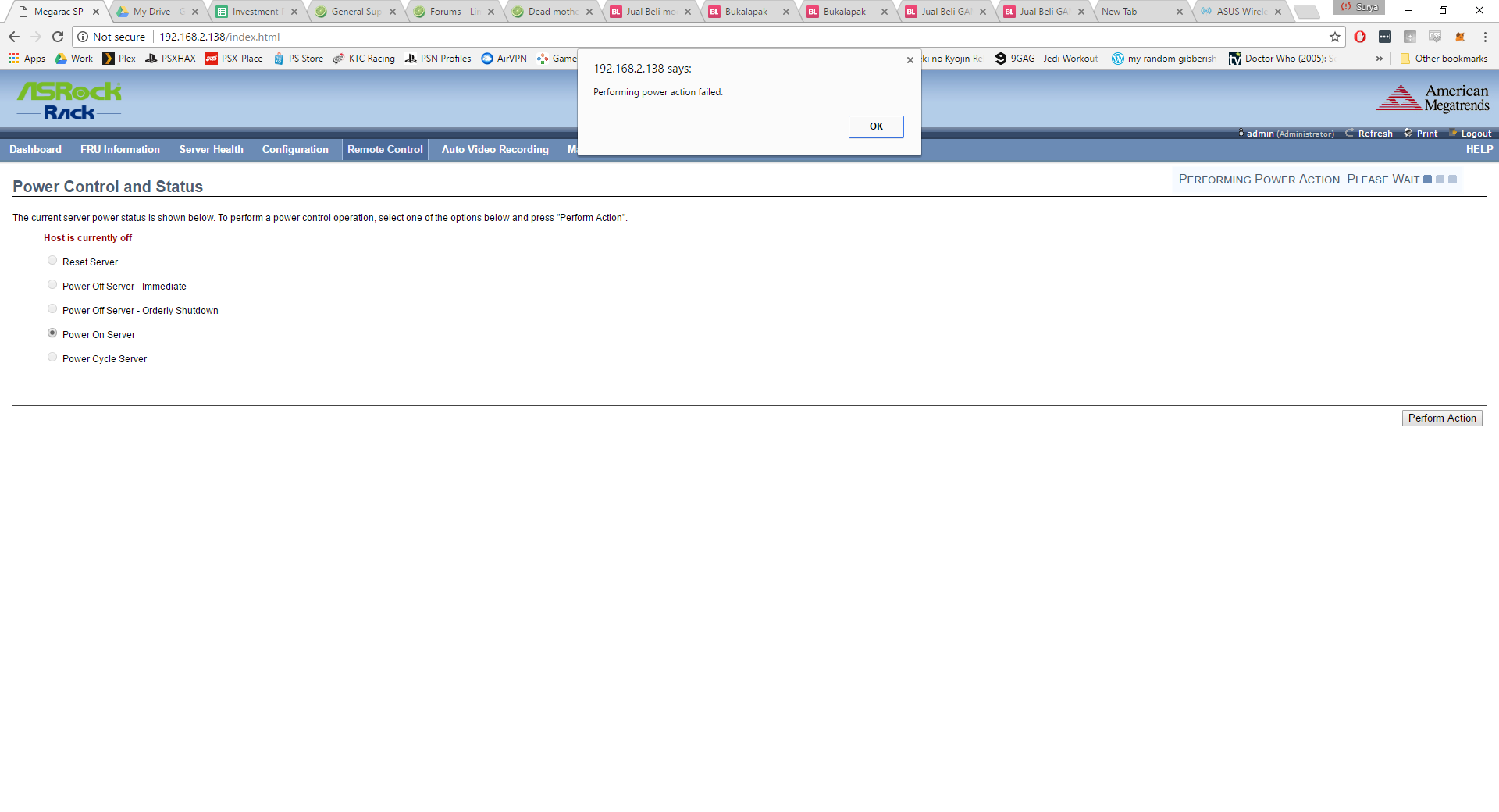

Ouch that sucks, but I'm wondering why I can enter the MegaRac SP which resides in different DHCP.
EDIT: Nevermind, I can't access it now.. stuck at logging in page..

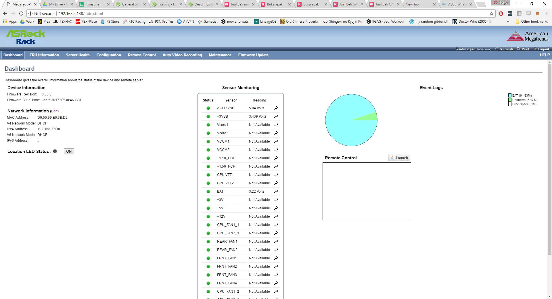

If you take a look, what is this BAT blue piechart means? I tried to google but I can't seem to get the meaning of BAT.

Curious if the PSU resolved the issue. I do not know what that blue "BAT" slice of the pie chart is trying to tell.
On the "server health" tab you can look at the event log, and probably figure out what "BAT" refers to.
Edited by cpshoemake
48 minutes ago, cpshoemake said:
"BAT" refers to.
CMOS battery
