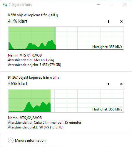

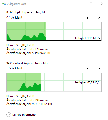

Fix Common Problems is giving me this error. When I transfer files to the server the speeds sometimes goes as low as 1MBps and then up to 70MBps after a few minutes.

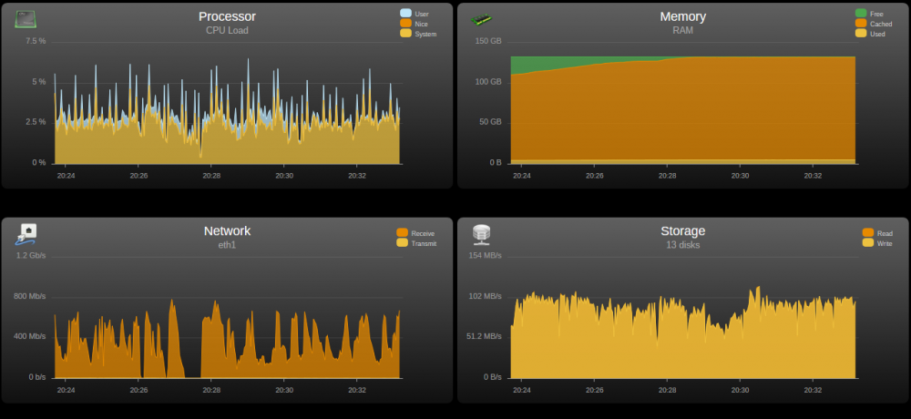

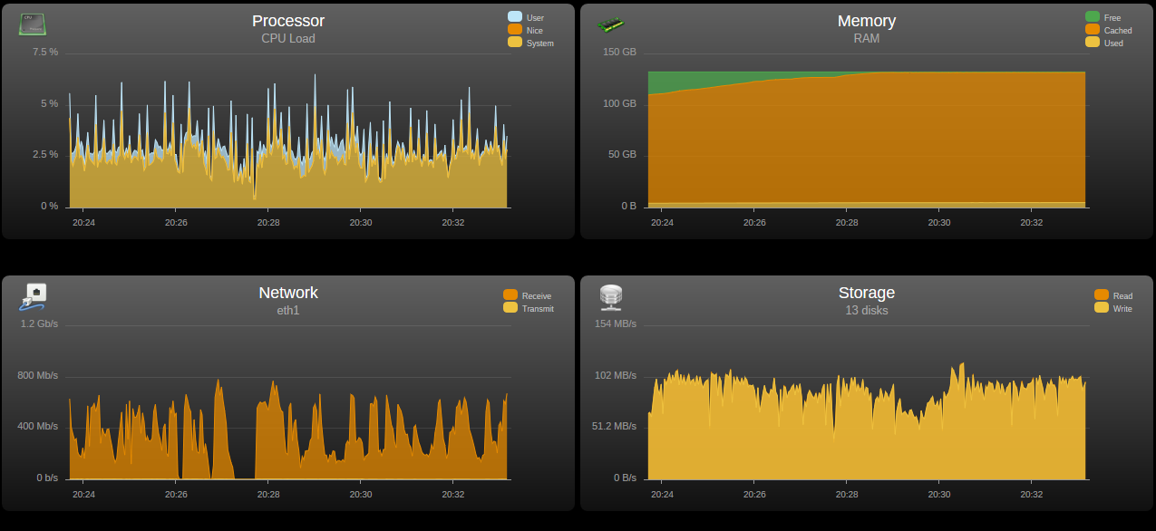

It's better than before, it doesn't stop completely, but it does drop a lot..
deusvult-diagnostics-20170524-2033.zip

Sometimes transferspeed drops to ~10MBps, I believe it averages somewhere around 40MBps. Much better, but still worse than I've had before. Does it matter if the share I transfer to is set to High-Water, Fill-up or Most-Free?
