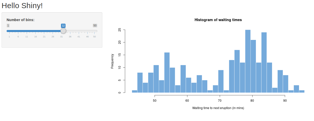

My goal with this docker is to host a dashboard for myself. When I launch a shiny app, It's listening on the localhost. I can use the arguments:
> shiny::runApp('FirstApp',port = 3838,launch.browser = FALSE)
Listening on http://127.0.0.1:3838
So, I configured the ports as above. When I go to my IP, "http://[IP]:3838", the page won't load... which tells me something else needs to happen. Any ideas what that might be?
Alright, so I kept tweeking. When running the app, I need to add the host argument to be the IP address assigned by docker. For example:
> shiny::runApp('FirstApp',port = 3838,host = '172.17.0.6',launch.browser = FALSE)
Listening on http://172.17.0.6:3838
Then...  I go to the address http://[MyUnraidIP]:3838   ... and there's shiny!!
