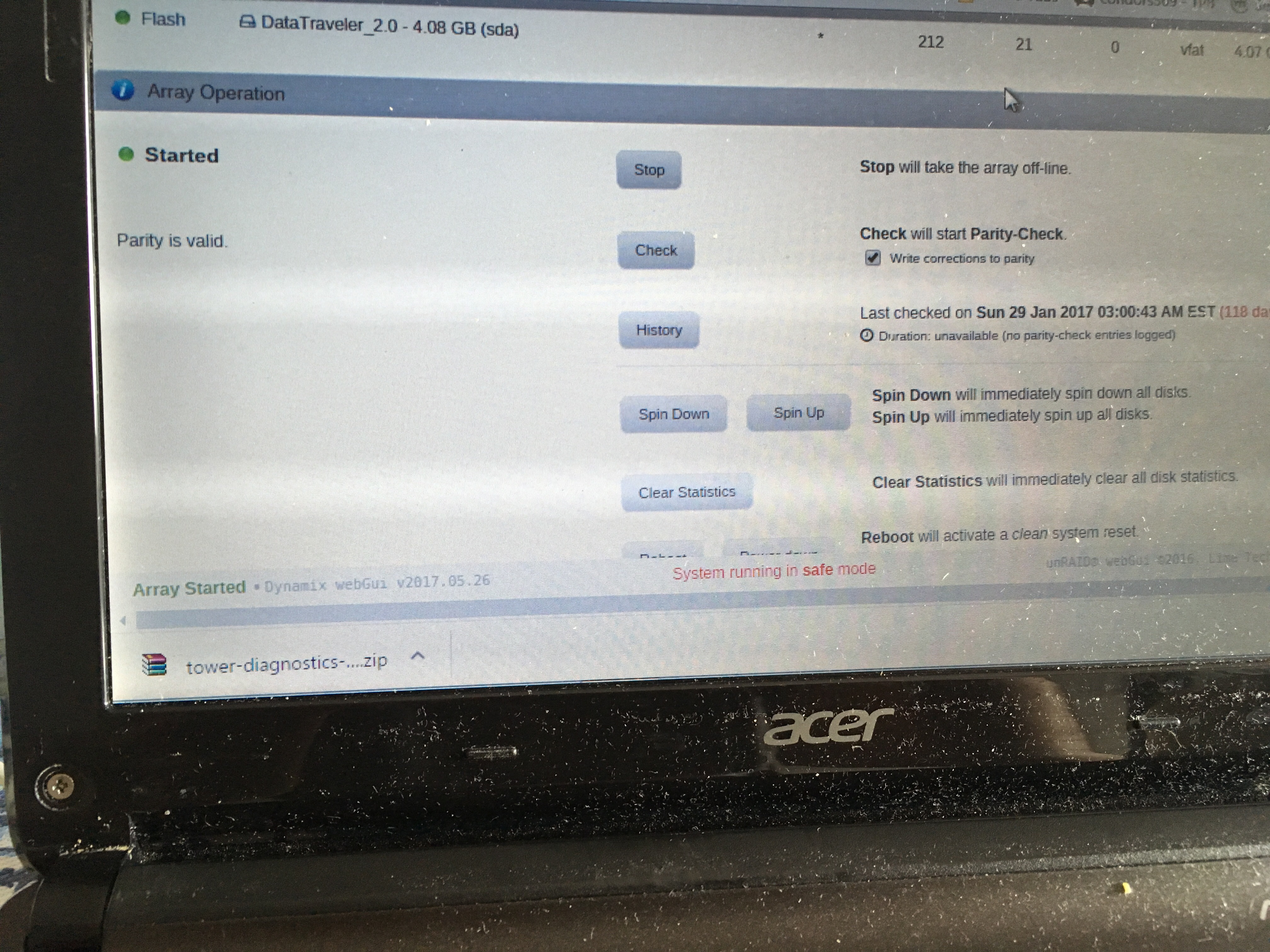

May 27, 20179 yr Author I tried booting up my server in safe mode and running with no plugins. I was able to start the array in safe mode. does this mean anything? I believe one of my docker apps was still running since one of my torrent files showed up as completed. I went in an manually stopped and rebooted in regular mode and still same crap. does this mean anything?

May 27, 20179 yr Author 2 minutes ago, johnnie.black said: In maintenance mode disk won't be mounted, so again can't help, but since you're in maintenance mode run xfs_repair on all array data disks (assuming filesystem in use is XFS): xfs_repair -v /dev/mdX Replace X with disk number. I meant to say that I have the array running in safemode. But its up and running. That last log was with the array in safe mode.
May 27, 20179 yr Community Expert OK, that's different, so disks are mounting and that means it's probably a plugin (or docker), start docker one at a time, if it's not that remove all plugins and add them one at a time.
