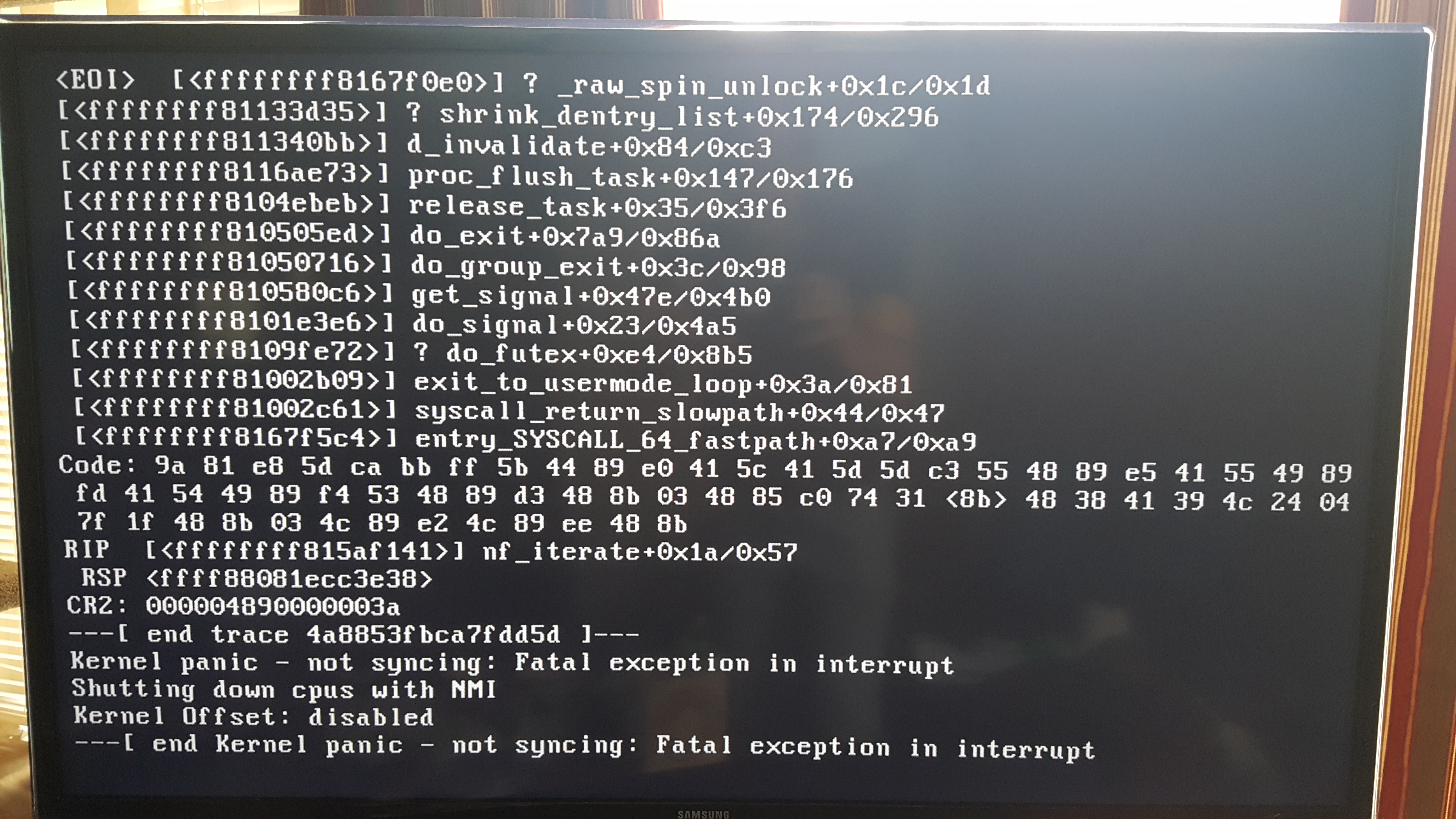

On a side note there is another issue.
On this last couple of reboots; which I had to do 4 times while writing this response, I was watching the monitor and noticed the BTRFS error again. I have no BTRFS drives according to the dash they state xfs.

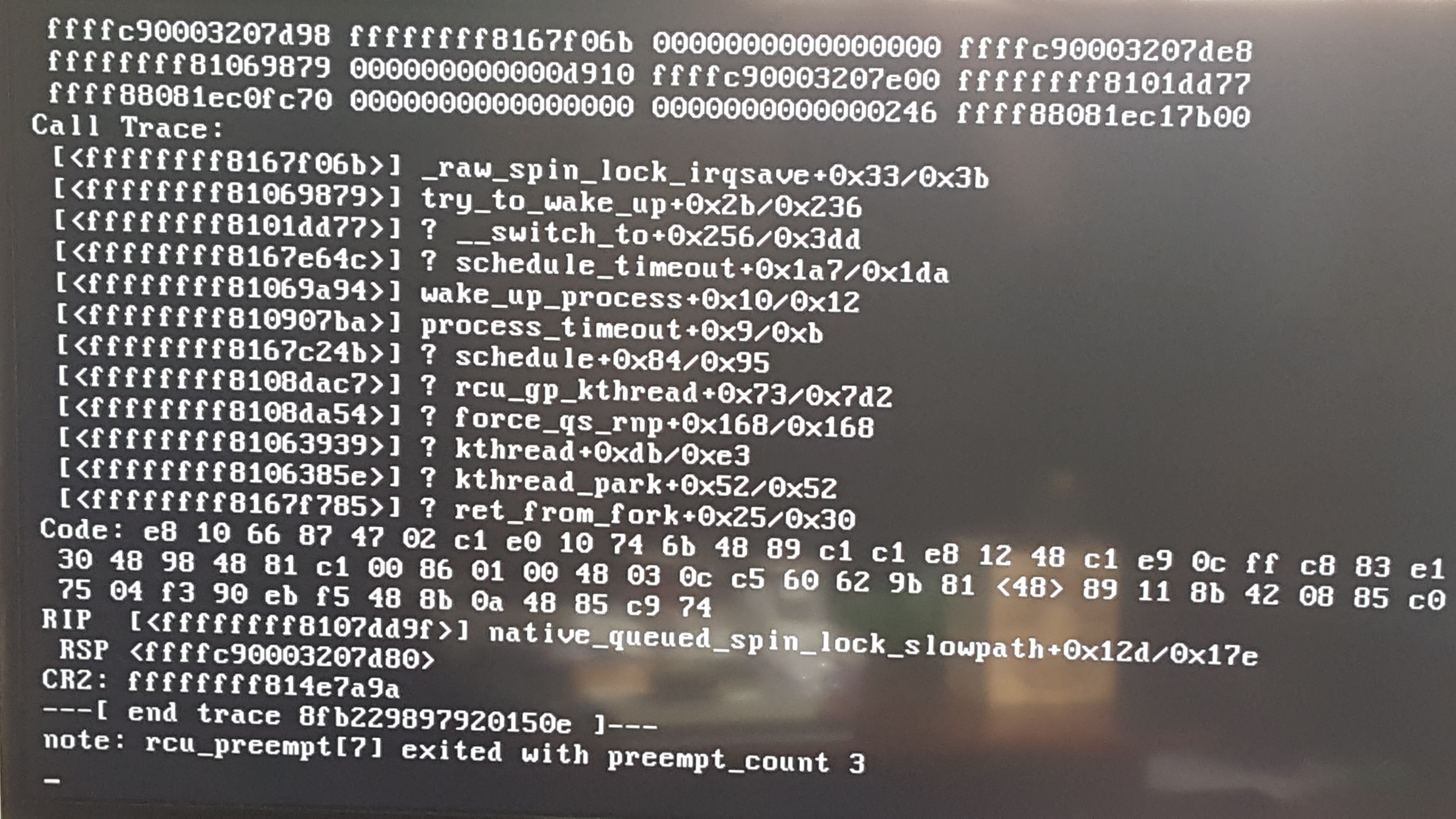

I happened to be watching the syslog file and managed to get a capture of it:

Jun  6 21:27:04 Tower kernel: Call Trace:
Jun  6 21:27:04 Tower kernel: [<ffffffff813a4a1b>] dump_stack+0x61/0x7e
Jun  6 21:27:04 Tower kernel: [<ffffffff810c8b8d>] bad_page+0xf3/0x10f
Jun  6 21:27:04 Tower kernel: [<ffffffff810c8c1d>] free_pages_check_bad+0x74/0x76
Jun  6 21:27:04 Tower kernel: [<ffffffff810c911b>] __free_pages_ok+0x1fd/0x223
Jun  6 21:27:04 Tower kernel: [<ffffffff810c9157>] free_compound_page+0x16/0x18
Jun  6 21:27:04 Tower kernel: [<ffffffff811148f7>] free_transhuge_page+0x90/0x97
Jun  6 21:27:04 Tower kernel: [<ffffffff810d1365>] __put_compound_page+0x1a/0x1d
Jun  6 21:27:04 Tower kernel: [<ffffffff810d155d>] release_pages+0xb2/0x2da
Jun  6 21:27:04 Tower kernel: [<ffffffff8111cf1c>] ? memcg_kmem_uncharge+0x51/0xcd
Jun  6 21:27:04 Tower kernel: [<ffffffff810fd421>] free_pages_and_swap_cache+0x6f/0x78
Jun  6 21:27:04 Tower kernel: [<ffffffff810e8c91>] tlb_flush_mmu_free+0x28/0x40
Jun  6 21:27:04 Tower kernel: [<ffffffff810eac4a>] unmap_page_range+0x35c/0x81a
Jun  6 21:27:04 Tower kernel: [<ffffffff810eb170>] unmap_single_vma+0x68/0x72
Jun  6 21:27:04 Tower kernel: [<ffffffff810eb3eb>] unmap_vmas+0x51/0x7e
Jun  6 21:27:04 Tower kernel: [<ffffffff810f215c>] exit_mmap+0x71/0x10c
Jun  6 21:27:04 Tower kernel: [<ffffffff8104a8a1>] ? put_task_stack+0x87/0x10e
Jun  6 21:27:04 Tower kernel: [<ffffffff8104aa4c>] mmput+0x48/0xec
Jun  6 21:27:04 Tower kernel: [<ffffffff8105019d>] do_exit+0x359/0x86a
Jun  6 21:27:04 Tower kernel: [<ffffffff81050716>] do_group_exit+0x3c/0x98
Jun  6 21:27:04 Tower kernel: [<ffffffff810580c6>] get_signal+0x47e/0x4b0
Jun  6 21:27:04 Tower kernel: [<ffffffff8101e3e6>] do_signal+0x23/0x4a5
Jun  6 21:27:04 Tower kernel: [<ffffffff8109fe54>] ? do_futex+0xc6/0x8b5
Jun  6 21:27:04 Tower kernel: [<ffffffff8106a144>] ? wake_up_new_task+0x16d/0x17a
Jun  6 21:27:04 Tower kernel: [<ffffffff81002b09>] exit_to_usermode_loop+0x3a/0x81
Jun  6 21:27:04 Tower kernel: [<ffffffff81002c61>] syscall_return_slowpath+0x44/0x47
Jun  6 21:27:04 Tower kernel: [<ffffffff8167f5c4>] entry_SYSCALL_64_fastpath+0xa7/0xa9
Message from syslogd@Tower at Jun  6 21:27:04 ...
 kernel:page:ffffea00000ab000 count:0 mapcount:0 mapping:          (null) index:0x0
 kernel:flags: 0x100000000000001(locked)
Jun  6 21:27:04 Tower kernel: BUG: Bad page state in process java  pfn:02ac0
Jun  6 21:27:04 Tower kernel: page:ffffea00000ab000 count:0 mapcount:0 mapping:          (null) index:0x0
Jun  6 21:27:04 Tower kernel: flags: 0x100000000000001(locked)
Jun  6 21:27:04 Tower kernel: page dumped because: PAGE_FLAGS_CHECK_AT_FREE flag(s) set
Jun  6 21:27:04 Tower kernel: bad because of flags: 0x1(locked)
Jun  6 21:27:04 Tower kernel: Modules linked in: xt_CHECKSUM iptable_mangle ipt_REJECT nf_reject_ipv4 ebtable_filter ebtables vhost_net tun vhost macvtap macvlan veth xt_nat ipt_MASQUERADE nf_nat_masquerade_ipv4 iptable_nat nf_conntrack_ipv4 nf_nat_ipv4 iptable_filter ip_tables nf_nat md_mod bonding hid_logitech_hidpp mxm_wmi igb kvm_amd ptp pl2303 i2c_piix4 pps_core i2c_algo_bit kvm usbserial i2c_core ahci hid_logitech_dj libahci wmi acpi_cpufreq [last unloaded: md_mod]
Jun  6 21:27:04 Tower kernel: CPU: 15 PID: 20719 Comm: java Tainted: G    B D         4.9.30-unRAID #1
Jun  6 21:27:04 Tower kernel: Hardware name: System manufacturer System Product Name/PRIME X370-PRO, BIOS 0604 04/06/2017
Jun  6 21:27:04 Tower kernel: ffffc90008e83930 ffffffff813a4a1b ffffea00000ab000 0000000000000001
Jun  6 21:27:04 Tower kernel: ffffc90008e83958 ffffffff810c8b8d 0000000000000001 ffffea00000a8000
Jun  6 21:27:04 Tower kernel: ffffea00000ab000 ffffc90008e83968 ffffffff810c8c1d ffffc90008e839a8
 kernel:page:ffffea0009898cc0 count:0 mapcount:0 mapping:          (null) index:0x1
 kernel:flags: 0x200000000000000()
Jun  6 21:27:04 Tower kernel: BUG: Bad page state in process java  pfn:262633
Jun  6 21:27:04 Tower kernel: page:ffffea0009898cc0 count:0 mapcount:0 mapping:          (null) index:0x1
Jun  6 21:27:04 Tower kernel: flags: 0x200000000000000()
Jun  6 21:27:04 Tower kernel: page dumped because: page still charged to cgroup
Jun  6 21:27:04 Tower kernel: page->mem_cgroup:0000000000000040
Jun  6 21:27:04 Tower kernel: ffffc90008e83930 ffffffff813a4a1b ffffea0009898cc0 0000000000000001
Jun  6 21:27:04 Tower kernel: ffffc90008e83958 ffffffff810c8b8d 0000000000000000 ffffea0009898000
Jun  6 21:27:04 Tower kernel: ffffea0009898cc0 ffffc90008e83968 ffffffff810c8c1d ffffc90008e839a8
 kernel:page:ffffea0004473cc0 count:0 mapcount:0 mapping:          (null) index:0x1
Jun  6 21:27:04 Tower kernel: BUG: Bad page state in process java  pfn:111cf3
Jun  6 21:27:04 Tower kernel: page:ffffea0004473cc0 count:0 mapcount:0 mapping:          (null) index:0x1
Jun  6 21:27:04 Tower kernel: ffffc90008e83930 ffffffff813a4a1b ffffea0004473cc0 0000000000000001
Jun  6 21:27:04 Tower kernel: ffffc90008e83958 ffffffff810c8b8d 0000000000000000 ffffea0004470000
Jun  6 21:27:04 Tower kernel: ffffea0004473cc0 ffffc90008e83968 ffffffff810c8c1d ffffc90008e839a8
 kernel:page:ffffea00010f0e80 count:0 mapcount:0 mapping:          (null) index:0x1
 kernel:flags: 0x100000000000000()
Jun  6 21:27:04 Tower kernel: BUG: Bad page state in process java  pfn:43c3a
Jun  6 21:27:04 Tower kernel: page:ffffea00010f0e80 count:0 mapcount:0 mapping:          (null) index:0x1
Jun  6 21:27:04 Tower kernel: flags: 0x100000000000000()
Jun  6 21:27:04 Tower kernel: page->mem_cgroup:0000000000000010
Jun  6 21:27:04 Tower kernel: ffffc90008e83930 ffffffff813a4a1b ffffea00010f0e80 0000000000000001
Jun  6 21:27:04 Tower kernel: ffffc90008e83958 ffffffff810c8b8d 0000000000000000 ffffea00010f0000
Jun  6 21:27:04 Tower kernel: ffffea00010f0e80 ffffc90008e83968 ffffffff810c8c1d ffffc90008e839a8

Jun  6 21:27:04 Tower kernel: [<ffffffff8115555c>] inotify_release+0x10/0x14
Jun  6 21:27:04 Tower kernel: [<ffffffff81122d49>] __fput+0xed/0x19f
Jun  6 21:27:04 Tower kernel: [<ffffffff81122e27>] ____fput+0x9/0xb
Jun  6 21:27:04 Tower kernel: [<ffffffff81062609>] task_work_run+0x6a/0x7d
Jun  6 21:27:04 Tower kernel: [<ffffffff810501f2>] do_exit+0x3ae/0x86a
Jun  6 21:27:04 Tower kernel: Code: 8b 67 38 48 89 fb 4d 8d ac 24 80 00 00 00 4c 89 ef e8 ae b0 52 00 48 8b 53 30 48 85 d2 74 18 48 8b 43 28 48 85 c0 48 89 02 74 04 <48> 89 50 08 48 c7 43 30 00 00 00 00 49 8d bc 24 28 02 00 00 48
Jun  6 21:27:04 Tower kernel: RIP  [<ffffffff81154006>] fsnotify_destroy_inode_mark+0x4b/0x83
Jun  6 21:27:04 Tower kernel: RSP <ffffc90008e83bd8>
Jun  6 21:27:04 Tower kernel: CR2: 0000000000000088
Jun  6 21:27:04 Tower kernel: ---[ end trace 6cf179fb5153f3ad ]---
Jun  6 21:27:04 Tower kernel: Fixing recursive fault but reboot is needed!

So I found that the Docker container(s) was causing the system to crash or lock up. I'm not sure which one was the culprit. Didn't see anything in the logs to indicate. So I downgraded the system back to 6.3.3 and completely recreated all my containers from new. Last night everything was working beautifully and this morning to. Then when I got to work the system completely stopped responding. The open SSH session that I was monitoring on a secondary computer showed no signs of problems and looked clean. I'll keep troubleshooting.
  • 4 weeks later...
I still have not found what is causing the system to keep freezing. I'm to the point now of just starting over from a fresh install.
I was in the process of backing up all my data on to an external drive and the system is still crashing. I have all VM's an Docker container disabled. I'm also noticing each time i do a hard reset the syslog is completely empty. In addition I dont see any log rotation like I have on my other machines.
You won't.  Syslog is all stored in RAM and lost with every reboot.  Install the fix common problems plugin, pop it into troubleshooting mode, then make your system crash / hang again, and upload the resulting files.
I did the troubleshooting mode for several day. I could not identify anything that was causing it to freeze. I went ahead and wiped the system and started from a fresh install. I came back today after a long weekend of fishing to find the system has frozen again. the only thing I'm running is apache, mysql, ngnix for dockers with the recommended plugins from Dynamix. This makes no sense to me. No method of access is working. Html, ssh, or even a simple ping. Any other recomendations would really be appreciated.
I just had a major system crash. Thankfully I had troubleshooting mode turned on thanks to Squid recommendation. Here is a copy of part of the log. I'm not quite sure what I'm looking at in most of this log. I think it might be the docker causing the problem. I have a fresh install of all my containers with nothing left over from the previous installation. I'm not sure why the system is crashing still.
log_copy_7-12-2017_1616.txt
I just came back from dinner and found the system had crashed again. I had turned off all VM's and Dockers since last reboot. I did have troubleshooting mode turned on but those log files show nothing. The only process that I had started was the Mover.
I'm almost to the point of scrapping the Unraid platform and moving to something more stable. A fresh install should not be causing me this much grief. I'm not doing anything that an average user would do with their system. Plex, simple web server, and nextcloud. I have the system behind a small to medium business grade firewall router with everything blocked but the http ports. I love the platform and what it is capable of, but there is a limit of the amount of time I'm willing to waste troubleshooting the system. Any help would be greatly appreciated. Thanks
Thousands of us run unraid with uptimes measured from weeks to months, only interrupted by planned shutdowns for upgrades or hardware maintenance.  Unraid as a platform is very stable. I suspect you have some hardware incompatibilities or undetected faults. Try running a memtest for 24 hours, and see if it shows any errors.
I did as you suggested. The memtest showed several errors. I have replaced the ram with new sticks. This was surprising as I had already did a memtest when I first installed the components. Thanks for the help. The new memtest with the new ram showed no errors. Lets cross our fingers. Thanks again.
