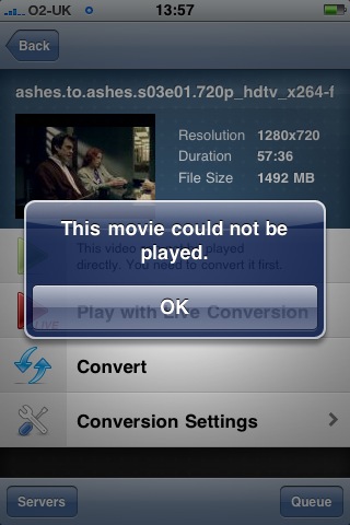

I've been giving it a go. I've got as far as installing the packages (that it complains about when trying to run it), being able to connect to the "server" (my test unRAID box), can view the folders & files *WITH THUMBNAILS*, but when I choose "play with live conversion" it is unable to play. Screenshot attached!
It's got something to do with ffmpeg I think. I've tried ffmpeg-20081102-i486-1gds.tgz and the ffmpeg file posted by "Admin" over at the airvideo forum but keps crapping out with the following error:
DEBUG: Encoder: /usr/bin/ffmpeg: unrecognized option '--conversion-id'
I am now in well above my head so not sure what to do next. Do I need to compile my own ffmpeg (in which case I'm screwed because I don't have a clue how)?
Can anyone help? I feel like I'm nearly there (but probably far from it!!! )

****** UPDATE: ******The problem is certainly something to do with the conversion. If I browse to a pre-converted .m4v then it works!
When I hit an error, code is as follows:
root@Tower:/boot/airvideo# bash air-video-server.sh test.properties

/usr/bin/ffmpeg --conversion-id 785851cf-5f5d-4084-8917-35f355055c38 --port-number 46631 -threads 4 -flags2 +fast -flags +loop -g 250 -keyint_min 25 -bf 0 -b_strategy 0 -cmp +chroma -deblockalpha 0 -deblockbeta 0 -refs 1 -coder 0 -me_range 16 -subq 5 -partitions +parti4x4+parti8x8+partp8x8 -trellis 0 -sc_threshold 40 -i_qfactor 0.71 -qcomp 0.6 -map 0.0:0.0 -map 0.1:0.1 -ss 0.0 -i "/mnt/user/media/Ashes to Ashes/ashes.to.ashes.s03e01.720p_hdtv_x264-fov.mkv" -cropleft 0 -cropright 0 -croptop 0 -cropbottom 0 -s 480x272 -aspect 1.7647059 -y -f mpegts -vcodec libx264 -bufsize 128k -b 1200k -bt 1300k -qmax 48 -qmin 2 -acodec libmp3lame -ab 192k -ar 48000 -ac 2 -
DEBUG: LiveConversion: Encoder thread exception: EOFException - null
DEBUG: LiveConversion: Encoder Process Done, closing segmenter.
The --conversion-id is an argument included in the Airvideo build of ffmpeg. I've tried to compile a binary for ffmpeg but now I get an  libx264 encoder error.
I'm in way above my head and have been fumbling for days (you could fit all I know of Linux on the back of a postage stamp..)
Does no-one have this working  ???
Resolved. See here
http://lime-technology.com/forum/index.php?topic=6097.0
