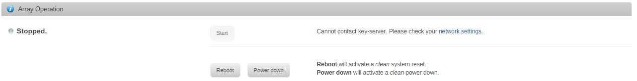

I am new to all this and i am trying to configure unRaid for the first time.
I have booted the unRaid from usb drive. Set the time. I added all drives to the array from 'Main' menu. One parity Drive, 3 Disk Drives, 1 Cache Drive. But in Array Operation it says 'Stopped' and 'Start' button is in gray (cannot press it) and it says "Cannot contact key-server. Please check your network setting." right in front of Start button.
So i cannot start an array.
I don't know what to do in network setting, or what i did wrong. Please help.

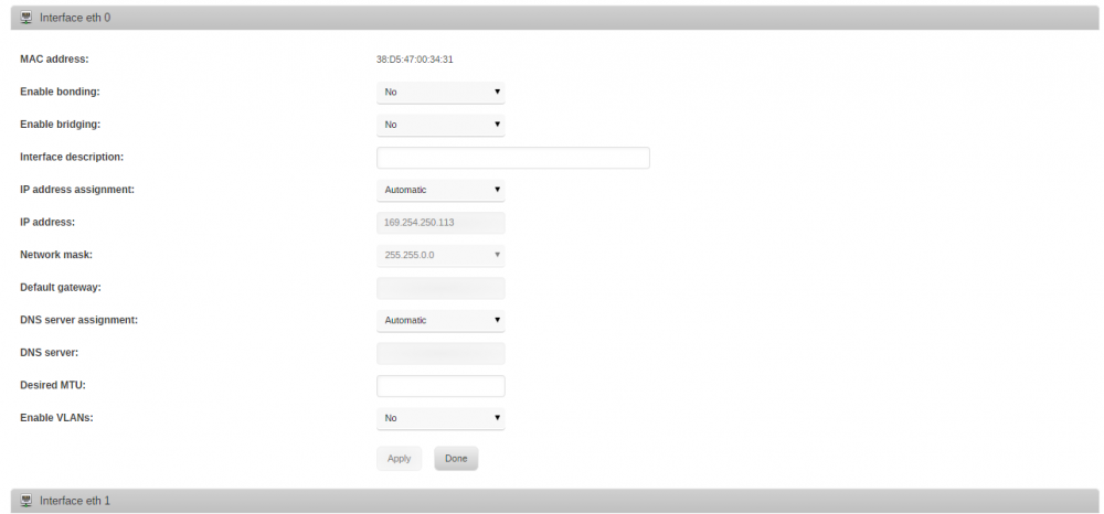

Attaching the error and network setting image bellow.

Your server is set to use DHCP to obtain network settings, but it is not able to contact a DHCP server (usually your router).
Is your router properly set up as DHCP server and check your wiring to ensure all parties can see each other.
Thanks bonienl.
My wiring was good but router wasn't set up as DHCP server.
Thanks a lot.
