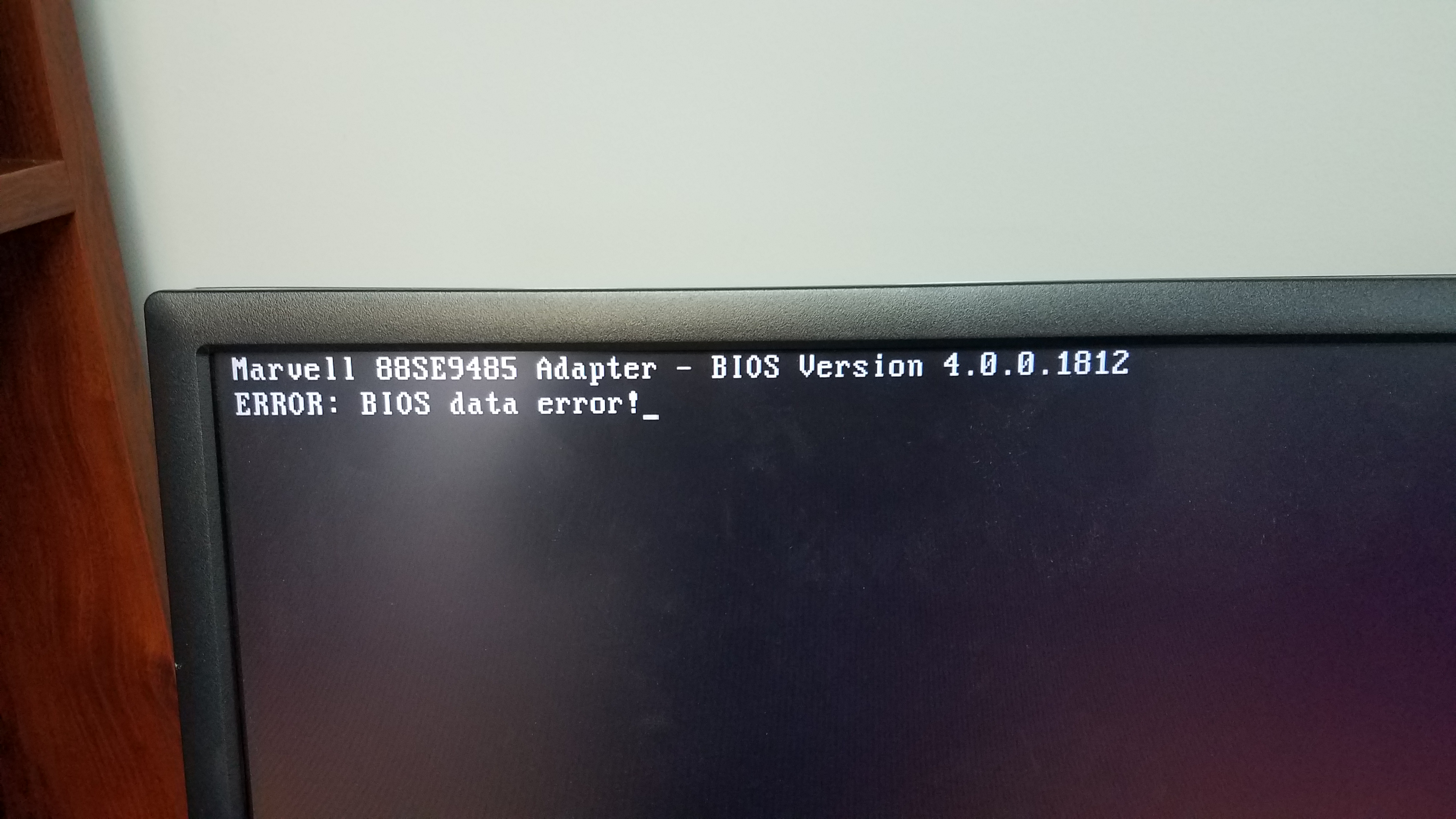

Upon booting I get BIOS data error!
When I put the card on the new motherboard it detects both drives and they show up as available to be added. So the slot might be bad in the Supermicro board.

Old board boots up fine, just the RAID controller quit working in that slot. So I think that PCI-E slot went bad.
Checked Virtualization and VT-d and both were already disabled.
I could (will) try to find an PCI 2 port SATA so I can plug that in to boot with those 2 drives.
I had the PC completely powered down and when I initially turned it on it seems that the RAID card was booting OK... then I got into BIOS to check settings and once out of BIOS it went back to the BIOS data error! again.

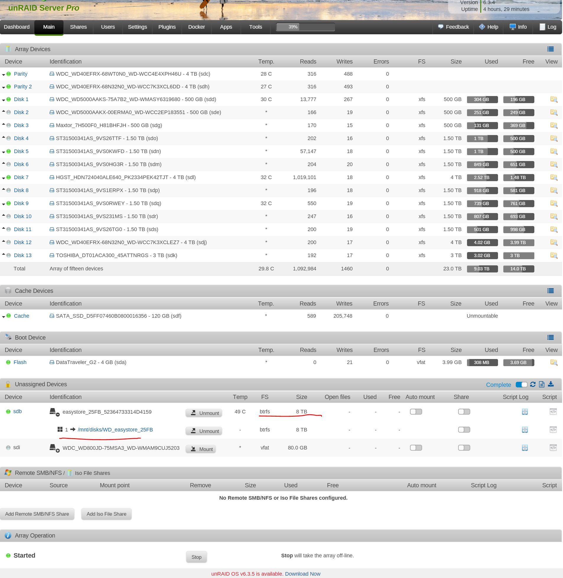

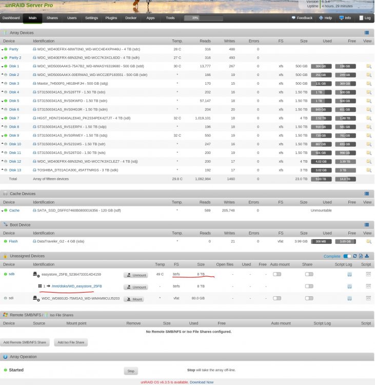

Here is the screenshot of the main menu. with the 8TB drive attached.

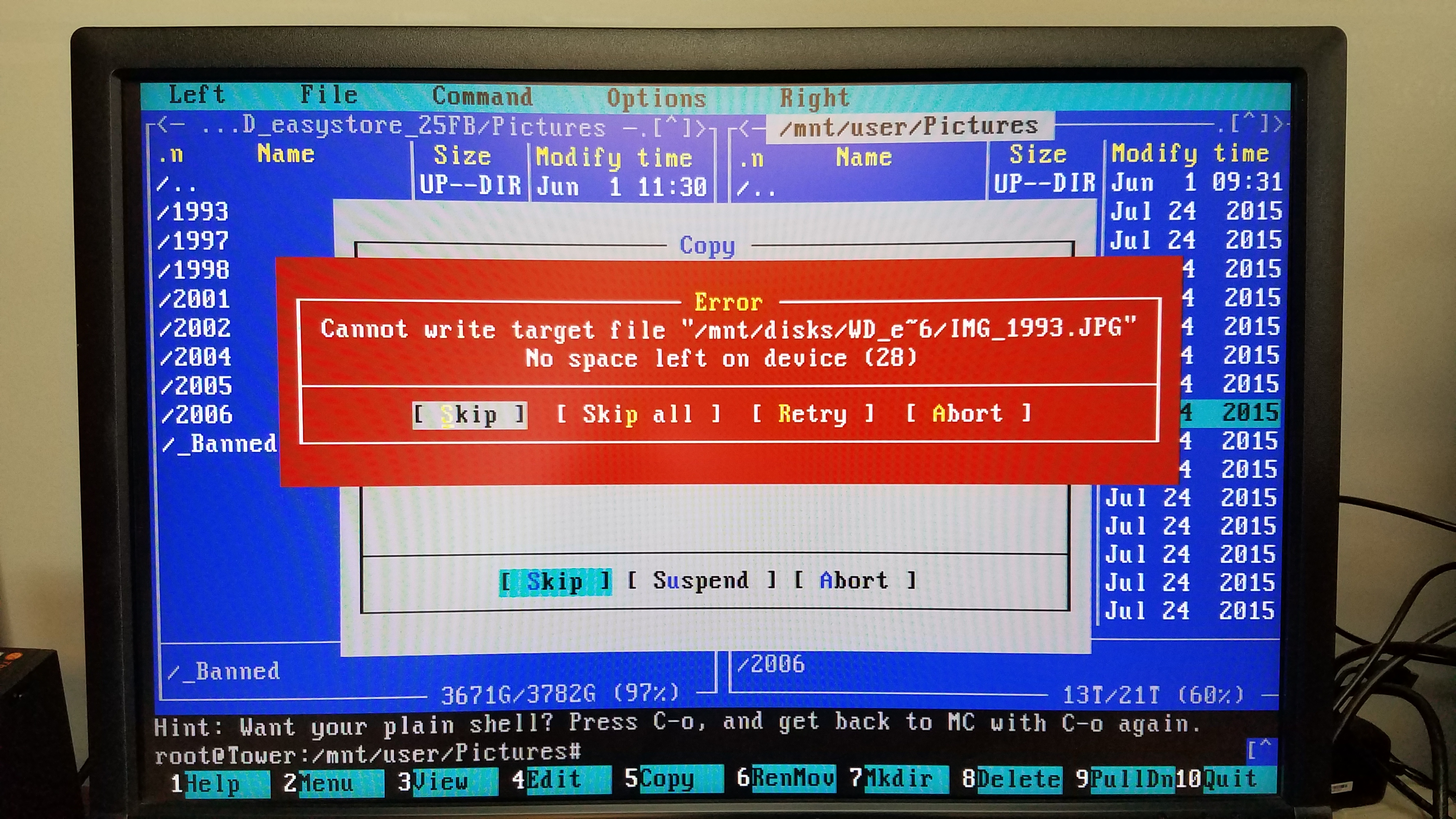

Here is what happens when I try copying from /mnt/user folder to the folder that it shows for drive.
As you can see in MC it shows 97% of the drive is free. (not sure why it only picks up 4TB out of 8 in there.
Might be Ok... I am copying out via LAN right now. Plugged the 2nd drive to my Win10 PC and also have a 16TB QNAP NAS here I have 80% of stuff backed up from UnRAID server already.
