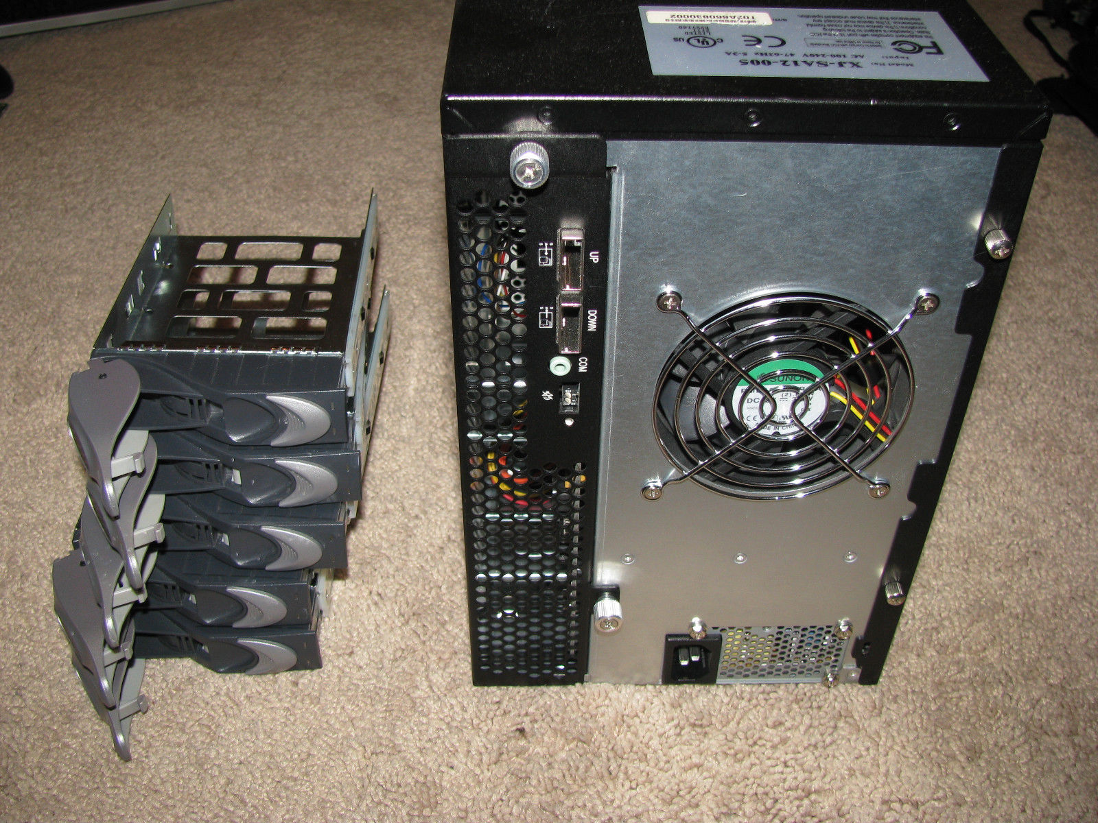

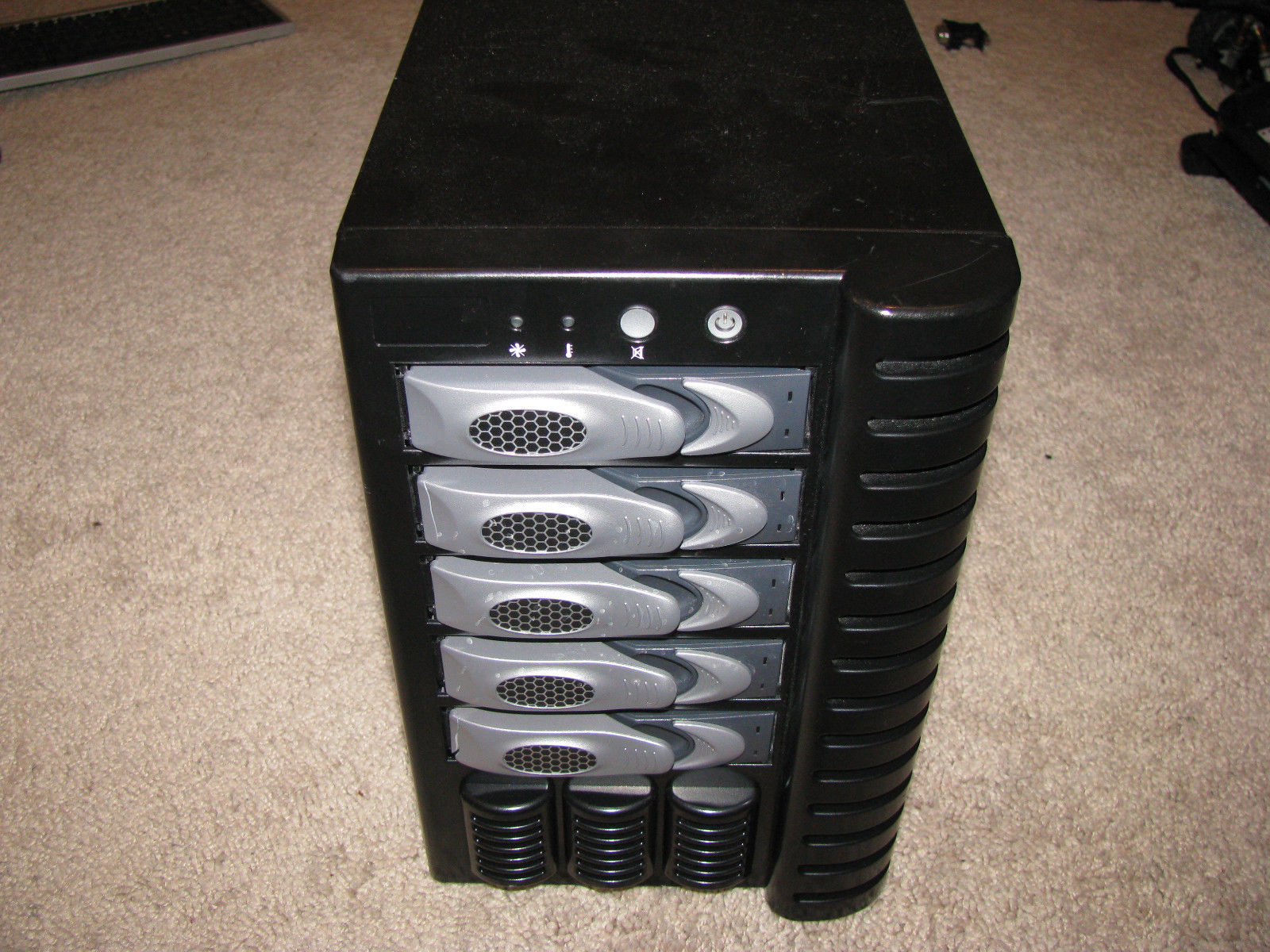

How many bays do you need? External SAS boxes are not very common and usually very expensive, found a cheap one recently on ebay, the Xtore XJ-SA12-005-B, it's a 5 bay SAS enclosure (with an expander) and works well, I first bought one to test and because I liked it and the seller was selling them so cheap at around 40€ each, and despite not knowing what I'm going to do with them I couldn't help myself and bough 4 more. :$
Like the MD1000 it's an older SAS1 model and these sometimes have some quirks with SATA devices, I've been testing mine and for a week and it works great with Samsung, Toshiba and Seagate (including 4 x 8TB archive) but doesn't like it when it's full of WD greens, i.e., with 5 x 2/3TB greens it only detects 3 or 4, haven't tested different WDs yet.
Performance is good, I expect to get 1100MB/s max (it's a single link SAS1 expander) and using the fastest disks I have I got max speed (5 x 200MB/s), so pretty happy with that.
There's also a 10 bay model (XJ-SA12-010-B), although I expect them to be pretty rare and performance won't be so good as the same 1100MB/s link will be shared by the 10 disks.

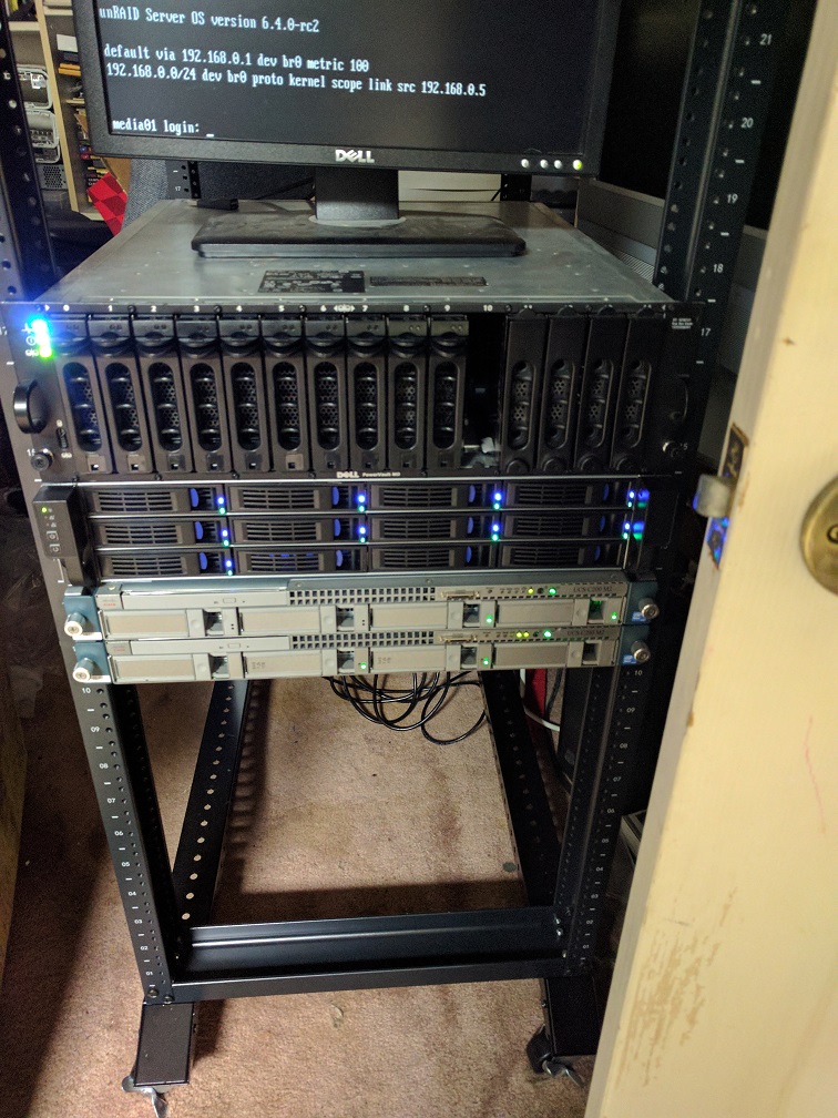

Got all the hardware in today, and moved everything over to the new setup (Main server is now the Cisco C200 M2 box w/dual x5650 6-core Xeons, 48G ram, 9207-4i4e Controller in the 8x slot, with the internal port connected to the 4 bays in the Cisco box, connected to a 500g SSD, 300GB 10k Raptor, and 2 4tb WD Reds in a Raid-0 config for parity, 1 external port connected to the Norco 12D box, with 4 Seagate 8tb Archive drives.  Cisco box has a 9201-16e in the 16x slot, with 2 ports connected to the other 2 ports on the 12D box, with several 3tb and 4tb drives).  Since I went from an Areca card to the LSI cards, I had to reformat and reconfigure the parity drives, so it's running a parity rebuild at the moment.  Not getting the greatest speeds (it's been bouncing anywhere between 30m/sec, and 140m/sec, averaging around 80m/sec).  I started a preclear of the new 8tb I added, and it shows it's running at 208m/sec).  The Areca card usually ran parity at around 120-130m pretty much all the way through a check, so either that card is just much faster (it did have a cache module and battery on it, but I can't remember if it had write caching turned on or not).  I'm definitely happy with the responsiveness of the new box, it's definitely faster than my old 8-core AMD FX setup...
(Yes, there are 2 C200's in there, plus the MD1000.  The 2nd box is running Unraid also, with a single VM running Windows 2016 Server, with our Altaro Offsite backup server set up on it for our Hyper-V box at the office).
