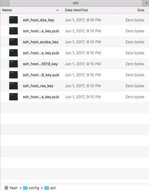

Thank you. Do you mean /config/ssh/ ? I don't have an /ssl/ folder in /config/.
All the ssh files are 0 bytes:
Thank you so much, that fixed the problem!!
