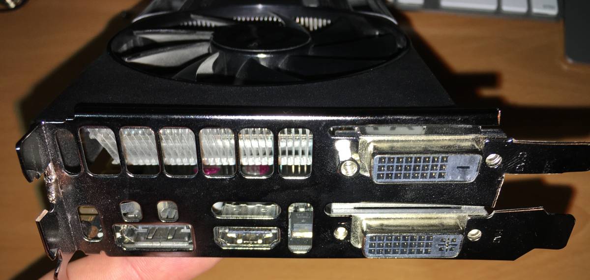

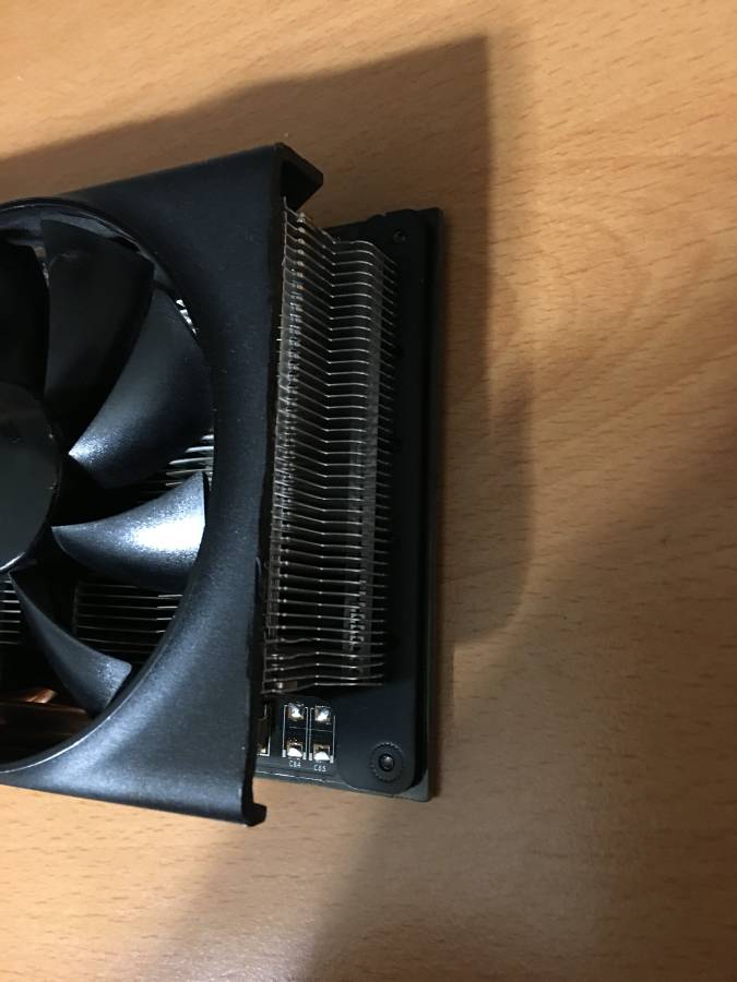

wont fit in my proliant. I had to trim the plastic shroud of the gtx 760 to get it to barely fit.... i'm a bit jealous of your spaciousness.
also had to hack the bracket....
that bracket is now used on the 1050 card since it already worked. I should have cut the server instead, but I couldn't bring myself to do that.
