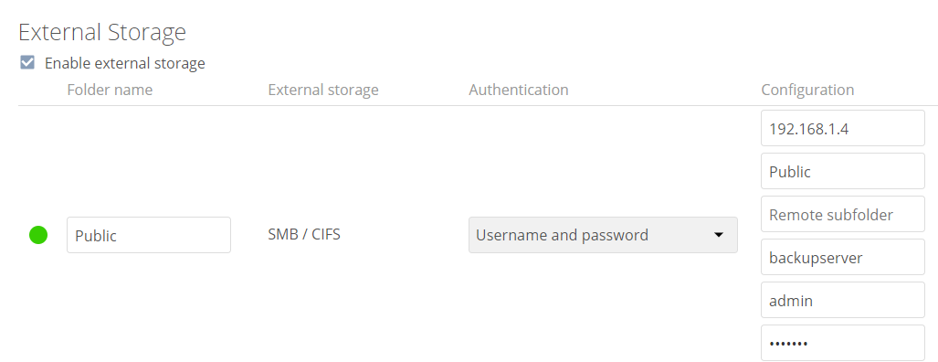

I have been working to get the CIFS mounts working and have succeeded.  I had to add a package to the Docker and finally figured out how to successfully set up a CIFS mount.
Update the Docker and when setting up the CIFS mount, do the following:
  • Select 'Username and password' for authentication.
  • Use the server name or IP address of the server for the 'Host'.
  • Enter the 'Share' name on the server.
  • Use the server name as the 'Domain'.
  • Enter credentials.

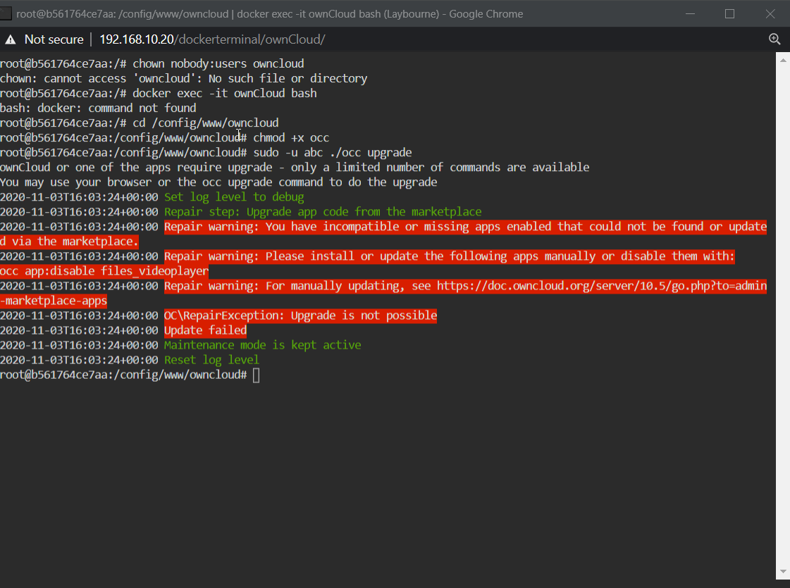

I too found myself in this position. I am working through the upgrade on the -legacy repo, but I am getting the following when trying to run the occ upgrade.
"root@myidhere:/config/www/owncloud# sudo -u abc ./occ upgrade
This version of ownCloud requires at least PHP 7.2.0
You are currently running PHP 7.1.33-4+ubuntu18.04.1+deb.sury.org+1. Please update your PHP version."
So I think I am stuck between repo versions trying to get 10.5 up and going. Thoughts?

I'm building the legacy docker with php 7.2 now.
Your the best, thank you so much!!

Understood, but life gets busy. I'll do my best. Upgrade went perfect on the new legacy build. Thanks again.
