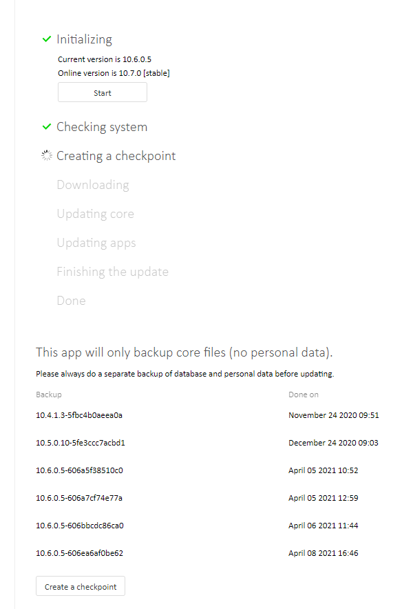

I'm having an issue upgrading from 10.6.0 to 10.7.0.  When using the built in upgrader the process stalls at creating a checkpoint, which its completed multiple times now. it never seems to complete this step.
I've set the permissions to /config by:
chown -R www-data:www-data /config
but nothing seems to allow me to get past this checkpoint after letting it run for 12+ hours. nothing shows in the docker log.
switching to php 7.3 (from 7.2) seems to fail.   Any help/tips here?
It is recommended that you do the update manually.  Read the second post on the procedure.
