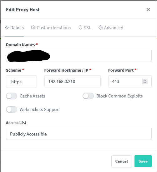

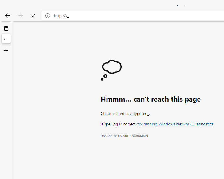

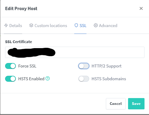

Hi guys, I give up. I need help.
I have installed the docker. Everything fine. Now I'm trying to access it via NginxProxyManager. I have set up the host to redirect to https, 192.168.x.x, port 443, using a letsencrypt certificate. Works like a charm for literally every docker apart from this one. Worked for nextcloud flawlessly, but I got fed up with Nextcloud when it decided to die again after an update and turned out impossible to fix, because of this or that. Nevermind.
when I access locally with an IP - https://myip - everything is cool.
As soon as I try to access via myhost.example.com - it redirects to either https://_ or https://_/login
Here's my config.php:

The result is https://_ - as on the attached picture.
Some time ago when I switched to http it seemed to work, the only problem was - I was able to see the owncloud interface, but the files would not load at all. The second I switched to local IP - works like a charm. Sooo yes, It technically could be the NginxProxyManager docker screwing things up. But it works for literally everything else, and it did work for nextcloud as well. Please help guys, I don't know what to do anymore.

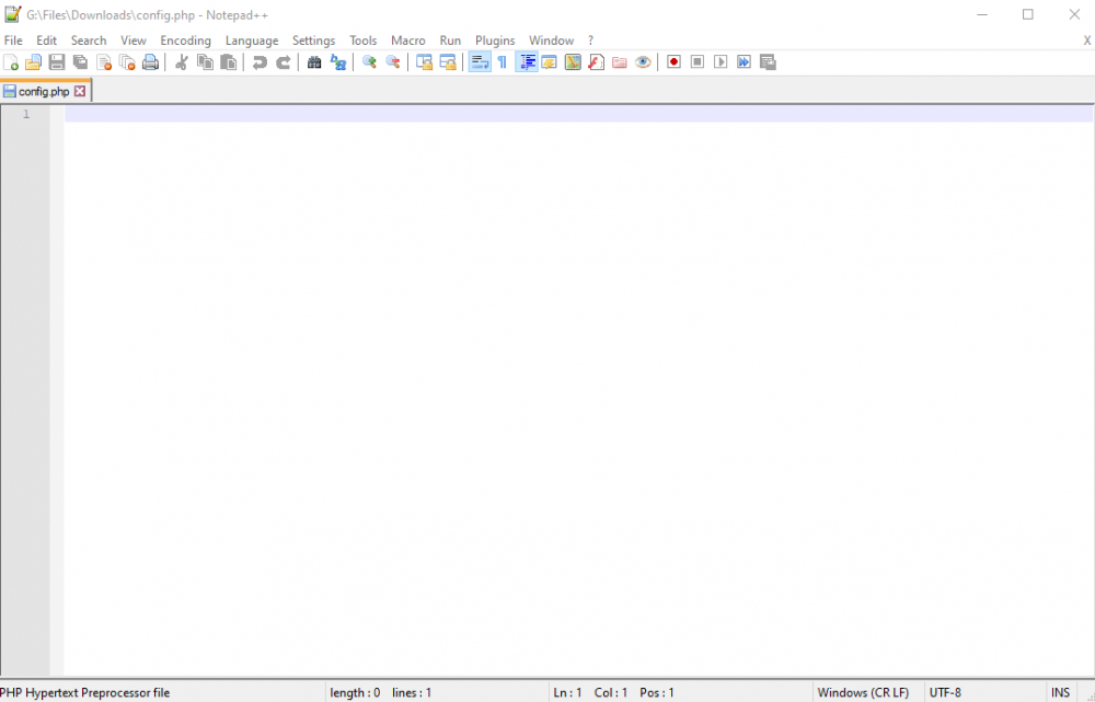

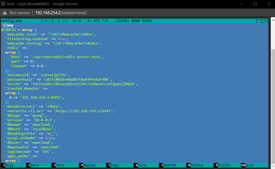

Hello, I know that this quoted comment was posted in 2017 but just to learn from this I would like to ask question. I'm new to unraid so don't have any idea. You said that I need to add this line to config.php but when I click the file via unraid gui, it will download the file. Now if I add that line, how can I upload back to the server?
I just wanna learn how to upload back with the new config file if there are scenarios like this in the future. Thank you.
Edited by HHUBS
add info
Use a Linux line editor and change the file at /appdata/config/www/owncloud/config/config.php.  That's the file the server uses.
Thank you. Ok I'm a windows guy and have a little knowledge on Linux but I figured it out how to check it.

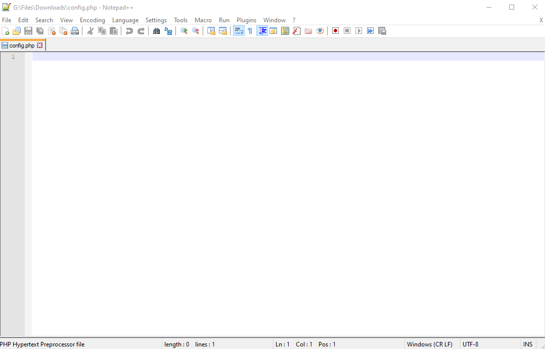

This is what I saw on the config.php but when I try to download it and look at it using notepad++ it doesn't show anything.
Can you explain this please? Thank you.
The reason why I want to download it and view it outside of unraid is that I want to check if I have made correct changes on the file or if it saved correctly.
Edited by HHUBS
You can't do it from the GUI.  As I said, get a linux compatible editor and edit it in place.

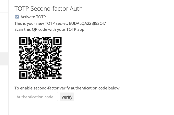

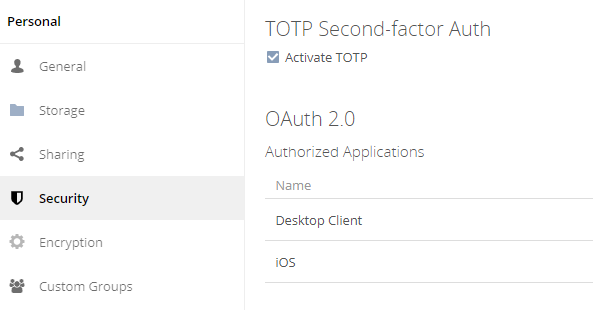

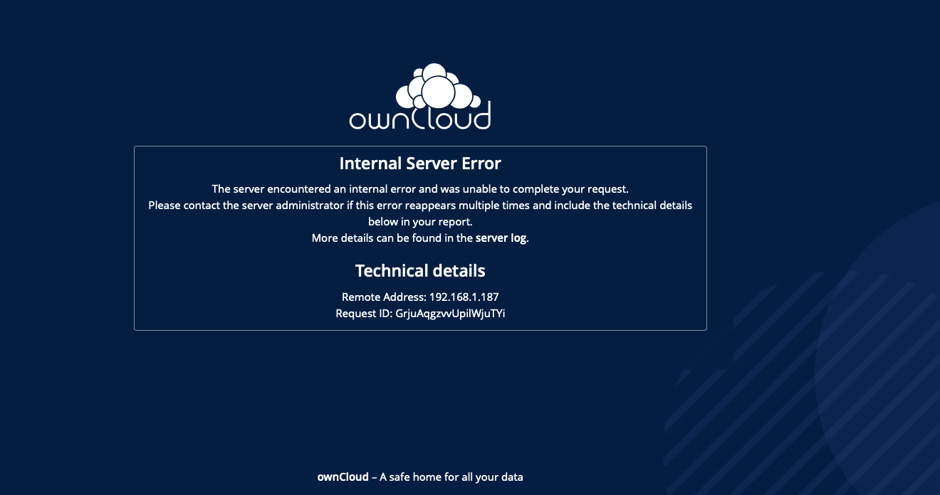

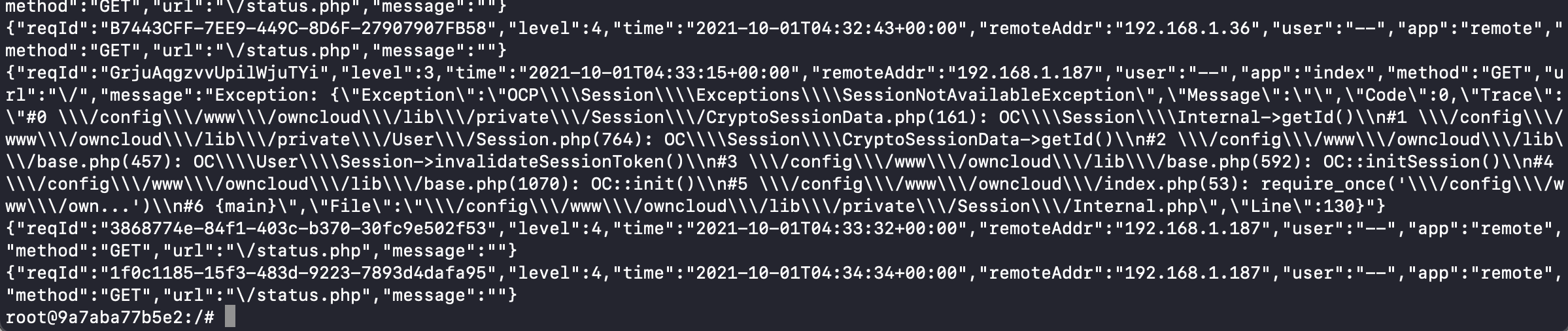

I'm trying to setup 2FA on owncloud. I already install the app on the market but when I activate the 2FA, it does not do anything. No QR code is showing. Any idea? Thank you.
  • 4 weeks later...
php install in the container is missing imagick extension which is used for generating the QR code. Have opened a ticked in GitHub.

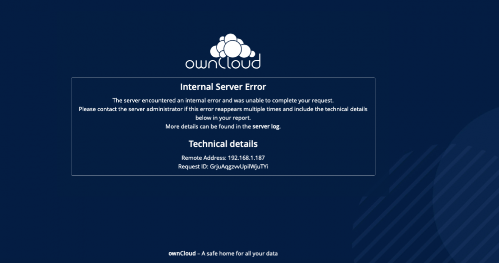

Hi dlandon - I have seem to run into some issues with the latest container version. I don't know if that is because of my environment and therefore seeking help.
  • I have looked at the permissions on the config and data directory and it seems to be ok.
  • The nginx and the DB logs look normal
  • Owncloud log reports "SessionNotAvailableException" error
I have tried a clean install by nuking the config directory and some folders in data directory and reinstalling the container. It works fine but after an array reboot - I seem to run into the issue. So either is my permissions or something in the container that breaks when it updates.
I have provided some information below. Do you know where should I look ?
EDIT :
Solved - https://central.owncloud.org/t/php-upgrade-breaks-owncloud/22841/4
Can this check be incorporated into the image please ?
