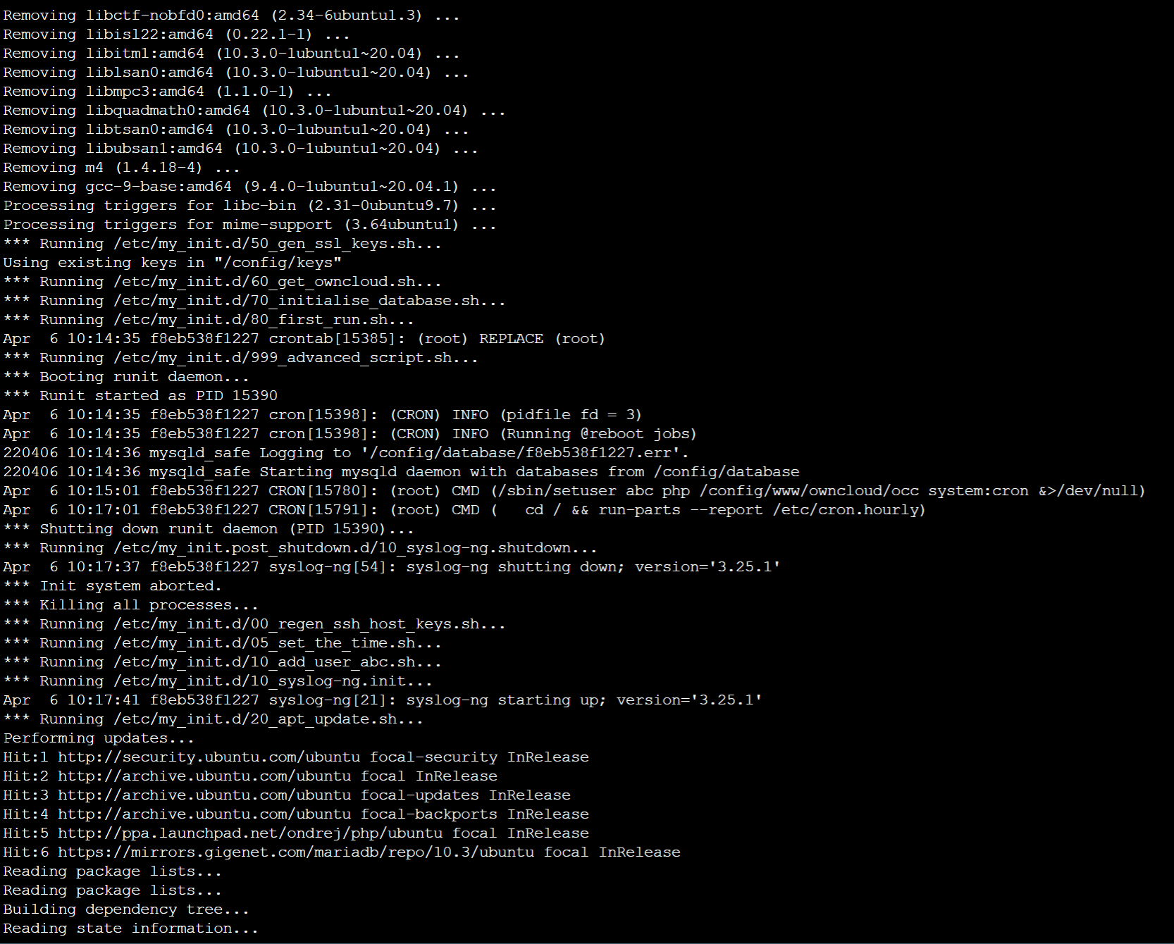

Thare's a way to disable autoupdate? It keeps happening although I don't want to. Maybe a environment value o extra post parameter will be nice if possible.

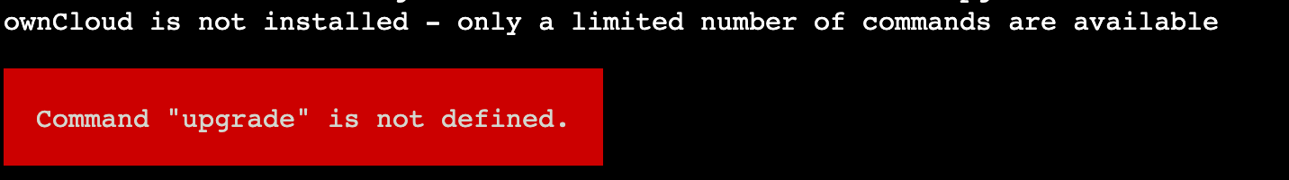

On 6/3/2017 at 10:16 PM, dlandon said:
Manual update is the recommended way to update an existing ownCloud installation.
  • Disable apps - Calendar, Contacts, and any add on apps - Settings->Apps.
  • Access the ownCloud Docker 'docker exec -it ownCloud bash'.
  • Install nano 'apt-get install nano'.
  • Put ownCloud in maintenance mode by editing 'nano /config/www/owncloud/config/config.php'.
  • Stop ownCloud docker from the unRAID Docker UI.
  • Get into the unRAID command line.
  • Change directory to 'cd /mnt/user/appdata/ownCloud/www'.
  • Move the existing owncloud version 'mv ./owncloud ./owncloud-old'.
  • Download and unzip the owncloud update from here.  Copy update using a PC to \appdata\ownCloud\www\.
  • Go back to the Unraid command line.
  • Copy external apps 'cp -R /mnt/user/appdata/ownCloud/www/owncloud-old/apps-external/ /mnt/user/appdata/ownCloud/www/owncloud/apps-external/'.
  • Change ownership 'chown nobody:users owncloud'.
  • Copy the old version of config.php 'cp /mnt/user/appdata/ownCloud/www/owncloud-old/config/config.ph /mnt/user/appdata/ownCloud/www/owncloud/config/config.php'.
  • Start owncloud docker from unRAID Docker UI.
  • Change directory to new owncloud version 'cd /config/www/owncloud'.
  • Change occ to executable 'chmod +x occ''
  • Execute upgrade: 'sudo -u abc ./occ upgrade'.
  • Change permissions on owncloud 'chmod 755 /config/www/owncloud'.
  • Take ownCloud out of maintenance mode by editing 'nano /config/www/owncloud/config/config.php'.
  • Re-enable apps - Calendar, Contacts, and any add on apps.
I will follow it tonight. Thanks
The auto update is the container applying security and other updates to Ubuntu upon startup.  It is done because many users expose it to the Internet.
Why do you say it keeps happening?  It only happens when the container is started, and any previous updates are kept so it doesn't have to update again.

Is there any way to make the startup scripts not cause the docker container to fail to run? I'm seeing this in the logs every time I try to start ownCloud.
Hit:5 http://ppa.launchpad.net/ondrej/php/ubuntu focal InRelease
Hit:6 https://mirrors.gigenet.com/mariadb/repo/10.3/ubuntu focal InRelease
Reading package lists...
E: dpkg was interrupted, you must manually run 'dpkg --configure -a' to correct the problem.
*** /etc/my_init.d/20_apt_update.sh failed with status 100
I'd love for it to just start so I could exec in and run the dpkg line to fix it, but it dies every time. Any ideas on how to get past this?
Turn on the "Basic View" switch to select to the "Advanced View".  Then click on "Force Update".  It will load a fresh Docker Image.  See if that doesn't fix the issue.
That did the trick, thanks so much!

I tried to follow the upgrde instructions but when I connect back into the console of the docker container, the upgrade command fails:
Any ideas?
nevermind for now.
Edited by BliXem
reinstalled
