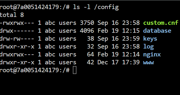

  • I had the same error. Make sure '/config/database' is owned by abc:users.   In Unraid/Docker tab, click ownCloud icon -> Console Run command: ls -l /config If it doe

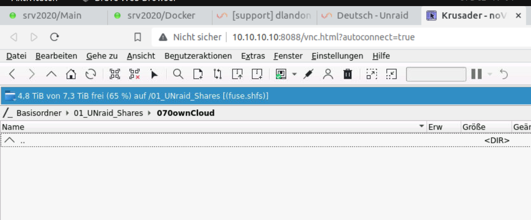

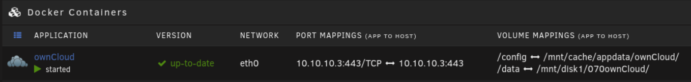

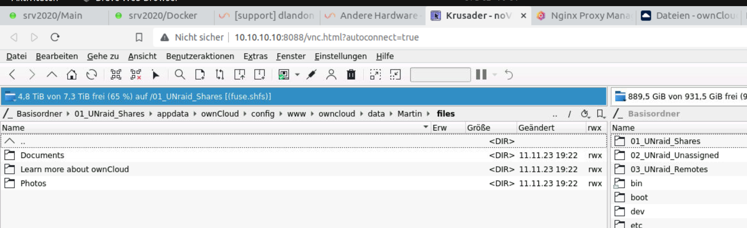

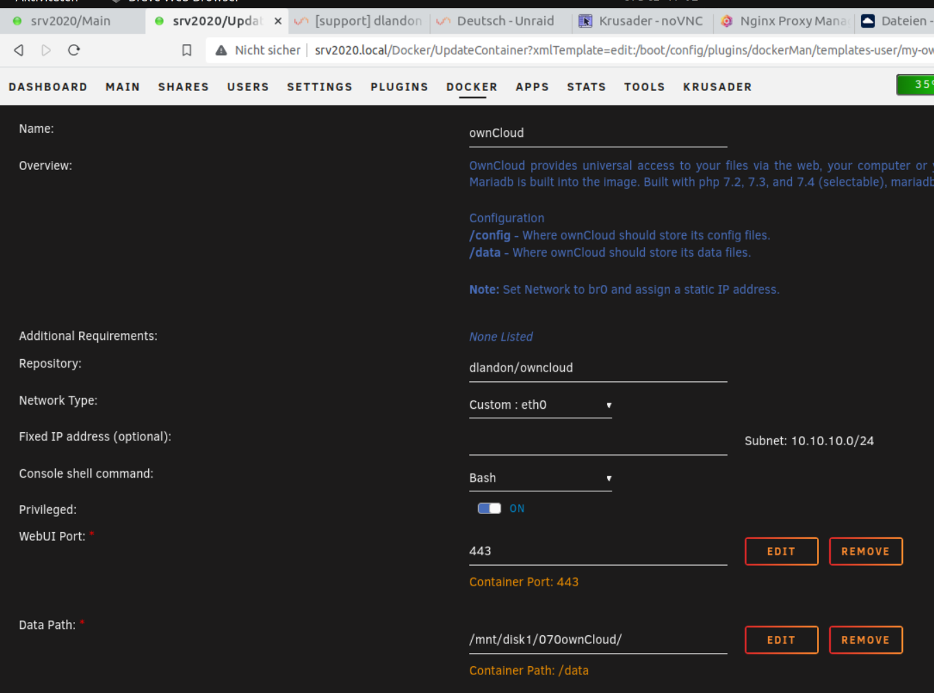

Hello.
I installed this yesterday.
After some Problems with Config.php i could solve them, using the Container Commandline and typing the correct Values with nano. Using the one in appdata didnt work. ?
So far so good. I can Access my Installation, using my Domain over nginx an also local using the IPadress.
Problem: I cant create a new Folder or File. My User is not allowed to do this.
After searching for the Problem i found out that the Data Folder ive chosen is not in use.
Instead, ownCloud is using the Appdata Folder. I already changed it from /mnt/user/070ownCloud/ to the current state but it does not take effekt.
I think i did something wrong but i dont know what.
Thanks and sorry for bad english.
Martin

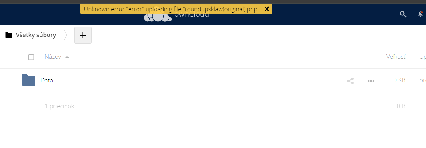

On 8/6/2023 at 4:07 PM, bonox said:
Hi dlandon, thanks for answering super fast.
You are right. Mapping was wrong. I did the change and now I'm able again to upload files.
But why did it work for years with apparently wrong settings? Anyways thanks for great and fast support.
How did you repair it man? I have also this problem. Thanks a lot for help.
Edited by techgeeksvk
