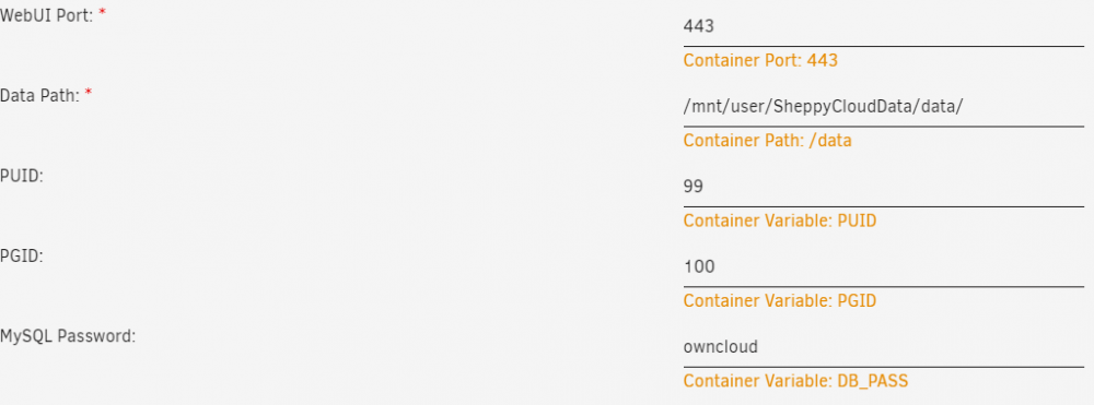

Hello there ^_^
im trying out Unraid and so far im completely up for it - just works great.
Also tried out your Docker of OwnCloud and managed to get it running completely behind 2 routers - also access from outside (my phone) via the OwnCloud App works great.
The only thing i would love to do --> put the /data folder onto my NAS HDD instead of the Cache Drive (mnt/disk1/OwnCloud)
 - The Data Folder atm is on my CacheDrive (mnt/cache/appdata/owncloud/www/owncloud/data/)
 - i would like to have it on my array disk1 in one of my shares (mnt/disk1/OwnCloud/)
What ive already tried:
- reinstalling it completely, clicking "edit" to edit the host path which is atm /mnt/user/appdata/ownCloud/data (at the Docker Configuration page before installation starts)
-> no matter which combination i try
---> host path to /mnt/disk1/owncloud or /mnt/disk1/owncloud/data (no matter if those folders are existing or not --> not working)
---> container path always remains /data (in my eyes its a value not to be changed - right?)
-> also tried to manually edit the /config/config.php
---> data path to /mnt/disk1/owncloud or /mnt/disk1/owncloud/data --> not working

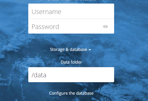

- changin data folder at the initialisation page at first start of owncloud from "/config/www/owncloud/data" to
---> /mnt/disk1/owncloud or /mnt/disk1/owncloud/data --> not working
- listing all users and groups via cut -d: -f1 /etc/passwd and cat /etc/group shows me that the user is "nobody" and the group is "users"
- creating all those folders and giving them the same rights (via sudo chown -R nobody:users /-data path-/) as the other files/folders have --> "drwxr-xr-x 1 nobody user"  --> not working
- cp -ar /mnt/cache/appdata/owncloud/www/owncloud/data /mnt/disk1/owncloud --> copies the folder with all rights correctly
- creating a softlink via ln -s /mnt/disk1/owncloud/data /mnt/cache/appdata/owncloud/www/owncloud (and also editing the rights matching) --> not working

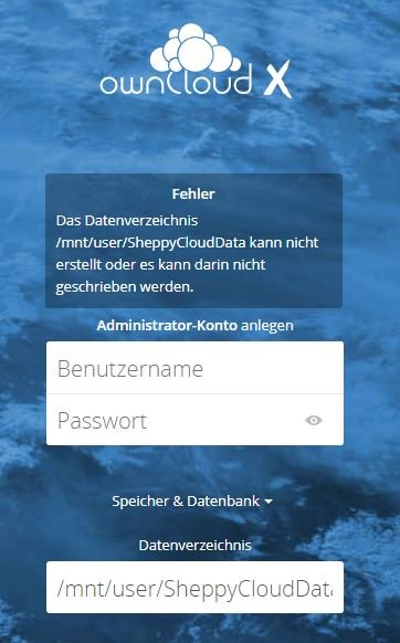

what i get:
- editing anything at the Docker Configuration page before the installation starts - doesnt changes anything - the data folder will always be on my cache drive
- editing the data folder path at the initialisation page at first start of owncloud results in "can not write or create data folder" (no matter which rights i give)
- moving the data folder and using a softlink gives me a page that data folder isnt reachable and .ocdata should be in the main folder
Question:
 - how can i get the data folder onto my disk1 ?
 - does owncloud accept softlinks?
 - was anything i already did somewhat right? xD (asides i learned a few things xD)
Thanks for your Help!
Greets SAM

Post your diagnostics.  I think your issue might be the way you've set up your shares.
here you go ...
Edited by CrazySam
problem solved

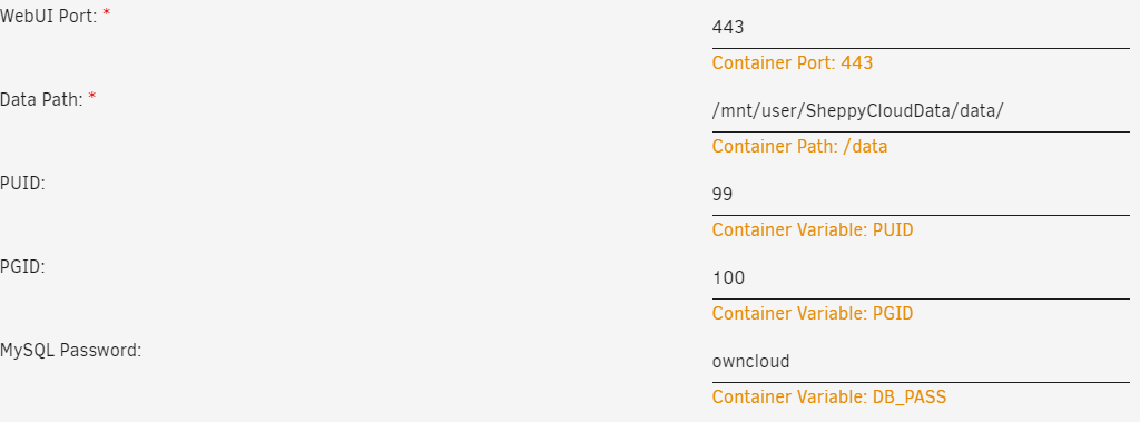

29 minutes ago, CrazySam said:
From what I can see, your shares are all on disk1.
You're mapping directly to the disk and not the share.  Don't do that, even if you have shared the disk1.
Do it this way.  Create a share called 'owncloud'.  Set it to use disk1 only.  Then map the config folder of ownCloud to '/mnt/user/owncloud'.  The /data folder will then be in this share and all of the /config will be located in the 'owncloud' share on disk1.
Always refer to shares by the mount point '/mnt/user/share'.  Never map to disks directly.  You will create problems!

5 minutes ago, CrazySam said:
In my eyes - if i put the config folder onto disk1 (the share via /mnt/user/share) then it means that my disk1 will be active 24/7 because owncloud is working in it.
If i only put my /data folder into the share then i thought that the disk1 would spin down if nobody access any data files shared in owncloud - thats why i intended only to have the /data folder on my share and the /config folder on my SSD.
You know what i mean (hope i could discribe my intentions the right way)
But ill continue my tests with your advices and note back.
My advice is to put the ownCloud /config on an SSD cache share.  Just putting the /data on disk 1 probably won't accomplish what you want depending on the activity on ownCloud.  Any /data file activity would spin up the disk.  i.e. uploading, downloading, or viewing files.
Put the ownCloud /config on a SSD cache, and back it up regularly to the array.  ownCloud has a plugin in the marketplace that does a database backup regularly, and you can safely copy the /data folder to the array with a User Script, even with ownCloud running.  You will also find that ownCloud will be more responsive on a SSD share.
If i try to set the Data path at first login ... i get this -_-
Rights to SheppyCloudData are set to "drwxrwxrwx 1 nobody users"
You didn't read the first post.
To install the docker from scratch:
  • Install docker and then go to the WebUI.
  • Enter an administration user and password.
  • Change the data folder to /data.
Start over.  This is the setup for your configuration.
This is the initial login setup.
yes! ... now its working and NOW i also get the relations of those folders inside the docker and inside owncloud - THANKS ^_^
Im new to everything - its the first time i handle with linux since i set Unraid as my OS - but i keep on learning ^_^
Thank you very much!
