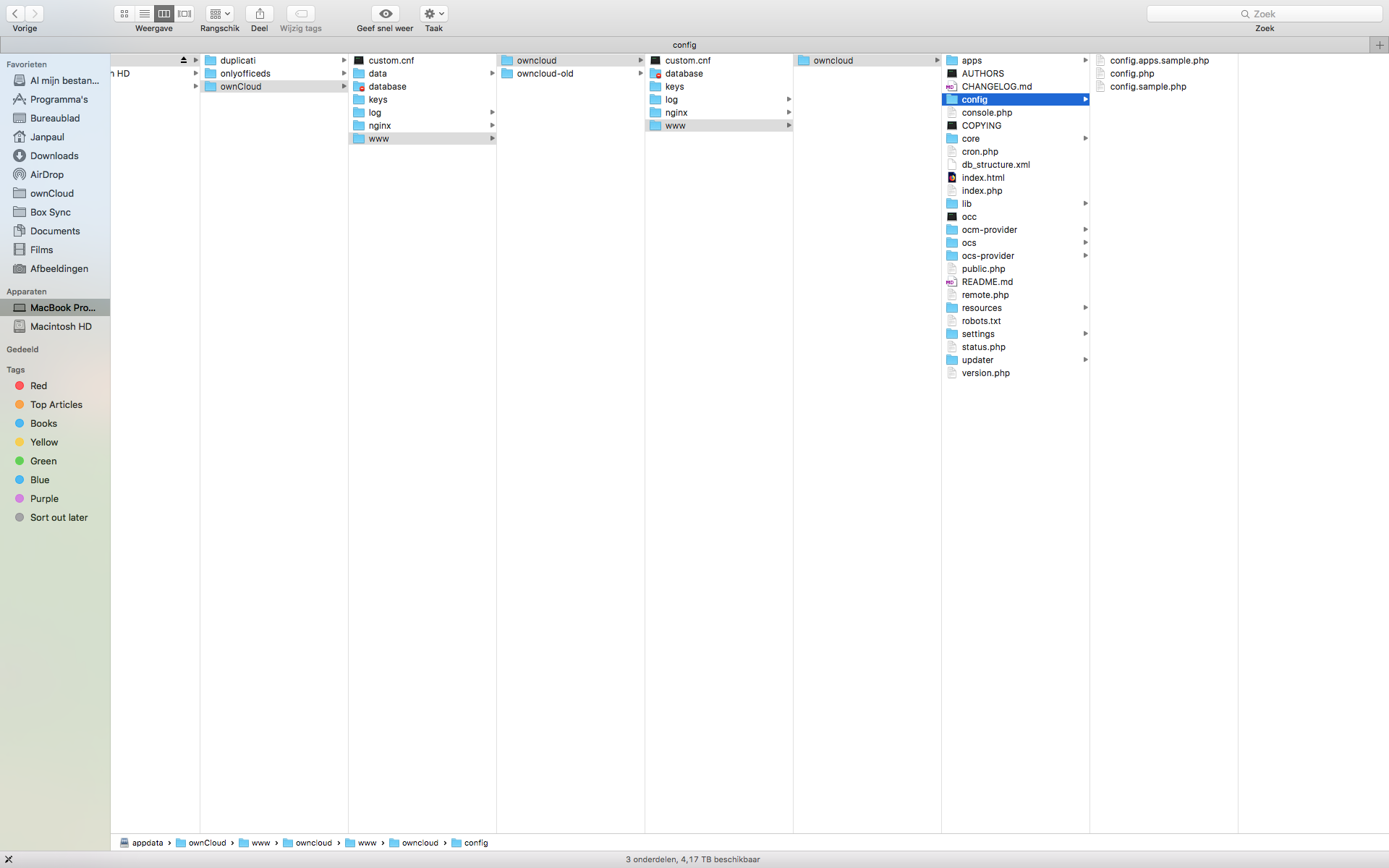

On 6/3/2017 at 10:16 PM, dlandon said:
For the moment this is a manual update method for an existing ownCloud installation.
  • Disable apps - Calendar, Contacts, and any add on apps.
  • Access the ownCloud Docker 'docker exec -it ownCloud bash'.
  • Put ownCloud in maintenance mode by editing 'nano /config/www/owncloud/config/config.php'.
  • Stop ownCloud docker from the unRAID Docker UI.
  • Get into the unRAID command line.
  • Change directory to 'cd /mnt/user/appdata/ownCloud/www'.
  • Move the existing owncloud version 'mv ./owncloud ./owncloud-old'.
  • Download and unzip the owncloud update.  Copy update to \appdata\ownCloud\www\.
  • Change ownership 'chown nobody:users owncloud'.
  • Copy the old version of config.php 'cp /mnt/user/appdata/ownCloud/www/owncloud-old/config/config.ph /mnt/user/appdata/ownCloud/www/owncloud/config/config.php'.
  • Start owncloud docker from unRAID Docker UI.
  • Change directory to new owncloud version 'cd /config/www/owncloud'.
  • Change occ to executable 'chmod +x occ''
  • Execute upgrade: 'sudo -u abc ./occ upgrade'.
  • Change permissions on owncloud 'chmod 755 /config/www/owncloud'.
  • Take ownCloud out of maintenance mode by editing 'nano /config/www/owncloud/config/config.php'.
  • Add Calendar, contacts, and other apps from the Marketplace.
  • Re-enable apps - Calendar, Contacts, and any add on apps.

Dear community members,
Would someone be so very kind to explain the following:
  1. "Download and unzip the owncloud update." Where could I find the link to find the download because I fear I cant find it (Probably I can't find water in the ocean). I found this: https://microbadger.com/images/owncloud/server
  2. "Change ownership 'chown nobody:users owncloud'." In what .php file should I be doing that?
  3. "Disable apps - Calendar, Contacts, and any add on apps." I just de-install them in the market place right?
I found some instructions.... but not as helpful: https://doc.owncloud.com/server/admin_manual/installation/docker/
https://owncloud.org/download/
Follow the instructions and you'll be in the right place.  It's not in a php file.
You can do that, or disable them - Settings->Apps.

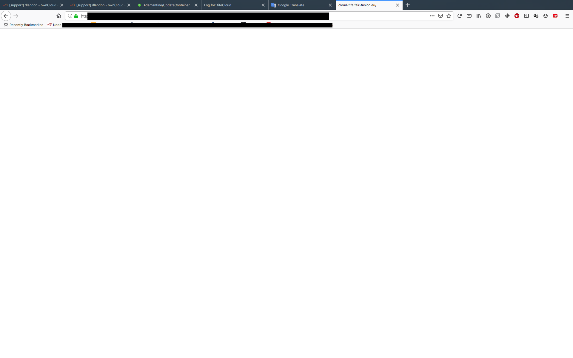

I'm very confused.  What does "no window would appear" mean?  What does "SSL does work but not webUI" mean?  You'll have to provide more meaningful information.  Show a screen shot of what is or is not working.
I means a blank page with no words image or anything, like the attached image below.
That in the URL bar the 'lock' for the SSL certificate is green so a connection between the user and host are made. However, there is no user interface...

Because, for some reason a whole new installation appears in
/mnt/user/appdata/ownCloud/www/ownCloud/www/
I feel I am very close at getting ownCloud starting and thereby getting everyone here back on track. Yet, I can't help to note that since the update went off-track maybe there is something more fundamentally wrong... any ideas? More important is to get things working again. Thank you in advance for your help.
This is an incorrect mapping.  If you just did the manual update, you need to check your work.
It should be:
With the owncloud files showing in that directory.

Dear dlandon,
Would you be so very kind to specify how we might incorporate the data back again? Would it be a case of temporarily copying the data to a different unRAID share > doing the complete install owncloud > shutting down owncloud > replacing the data folder and config.php file?
May I ask what issue or risk might occur by placing the data folder inside the www/owcloud folder?
Edited by LimeCenter
added question
I tried to reinstall the docker and replace the data folder and config.php file.... however with little luck. Key question now remains: what are the most suitable options to recover the data that were stored in the docker? i.e. not asking every computer/person to re-upload their data?
