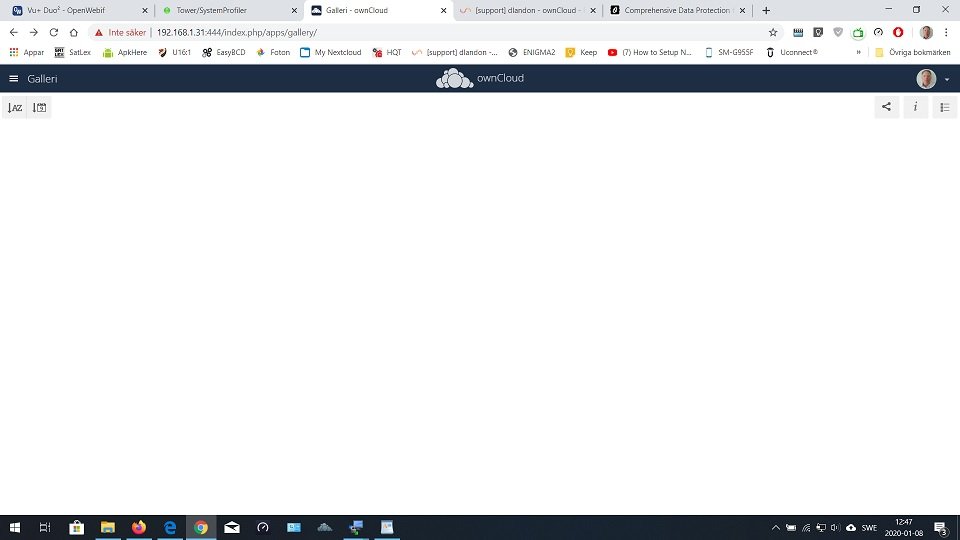

Hi, thank you for your Owncloud X, it's working awesome, for me this is the best working on my system, i've tested all the other versions, including the Nextcloud's.
Just want to ask about the Gallery app, can't get it to work properly, it doesn't show any picture.
Any help will be appreciate.
