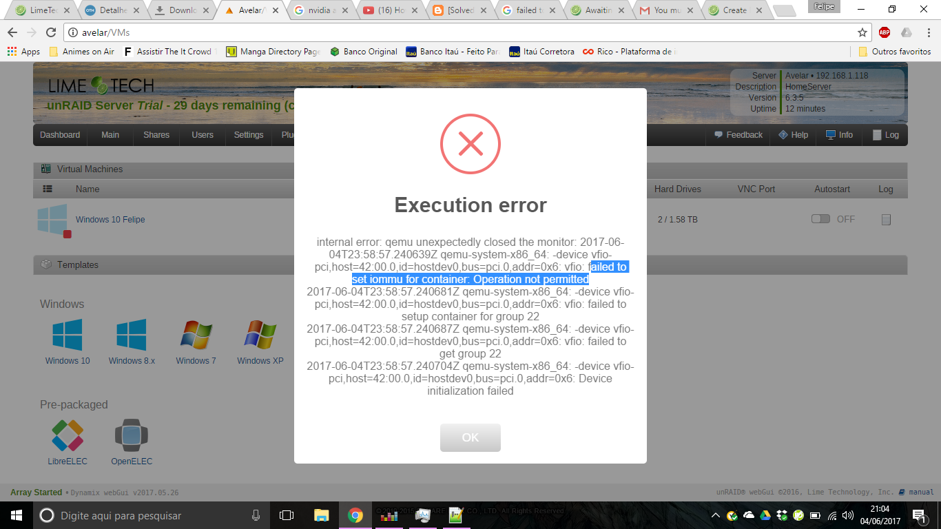

But i'm getting this error ( and screenshot is added as well ):
EXECUTION ERROR
"internal error: qemu unexpectedly closed the monitor: 2017-06-04T23:58:57.240639Z qemu-system-x86_64: -device vfio-pci,host=42:00.0,id=hostdev0,bus=pci.0,addr=0x6: vfio: failed to set iommu for container: Operation not permitted
2017-06-04T23:58:57.240681Z qemu-system-x86_64: -device vfio-pci,host=42:00.0,id=hostdev0,bus=pci.0,addr=0x6: vfio: failed to setup container for group 22
2017-06-04T23:58:57.240687Z qemu-system-x86_64: -device vfio-pci,host=42:00.0,id=hostdev0,bus=pci.0,addr=0x6: vfio: failed to get group 22
2017-06-04T23:58:57.240704Z qemu-system-x86_64: -device vfio-pci,host=42:00.0,id=hostdev0,bus=pci.0,addr=0x6: Device initialization failed"
Look like it's a gfx issue, what i'm supposed to do?
My xml is attached as well.
I really need help!
Thanks!
