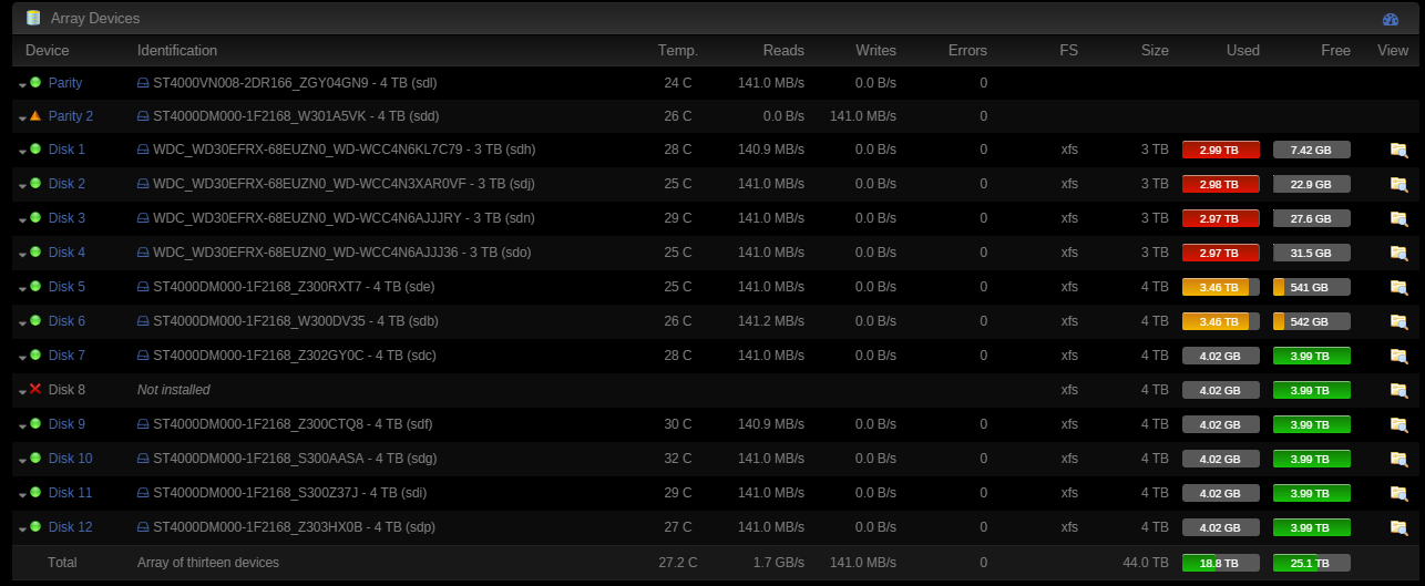

Accidentally added disk as Data Drive instead of Parity 2
I added in my Parity2 drive and selected all my additional data drives.
When i went to select start array it said you cannot do a disk replacement and add drives.
So i unselected Parity2 and clicked start array.
Somehow it added in the Parity2 disk into the Data array with all my other disks.
I couldn't do anything since it was starting the array, i went back in unselecting the disk i want to use for my Parity 2 and starting the array again.

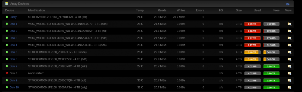

Now it has Disk 8 marked as not installed i never used it, how do i remove disk 8 from my array ?
helppp :(
Edited by Maticks

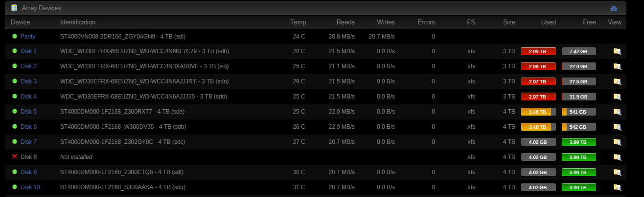

Parity2 is now building but arggg how do i remove Disk 8 from the array :(
You need to do a new config, reassign all disks are resync parity (tools -> new config)
i am beyond amazed, that worked so easily.
