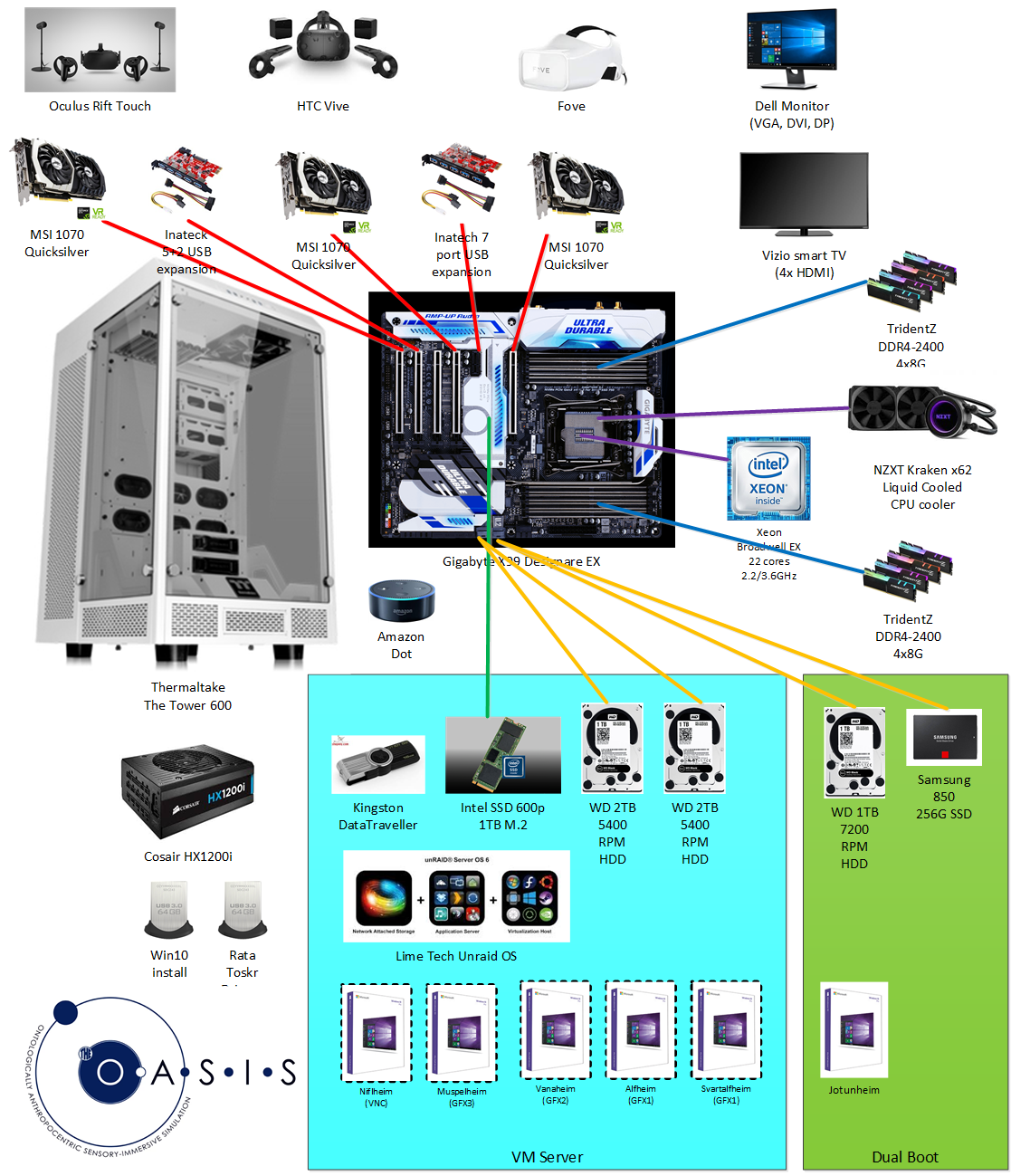

Is there a HW observation point where I could get lower level debug information over and above what unraid supplies?
HW diagram of system is attached.
