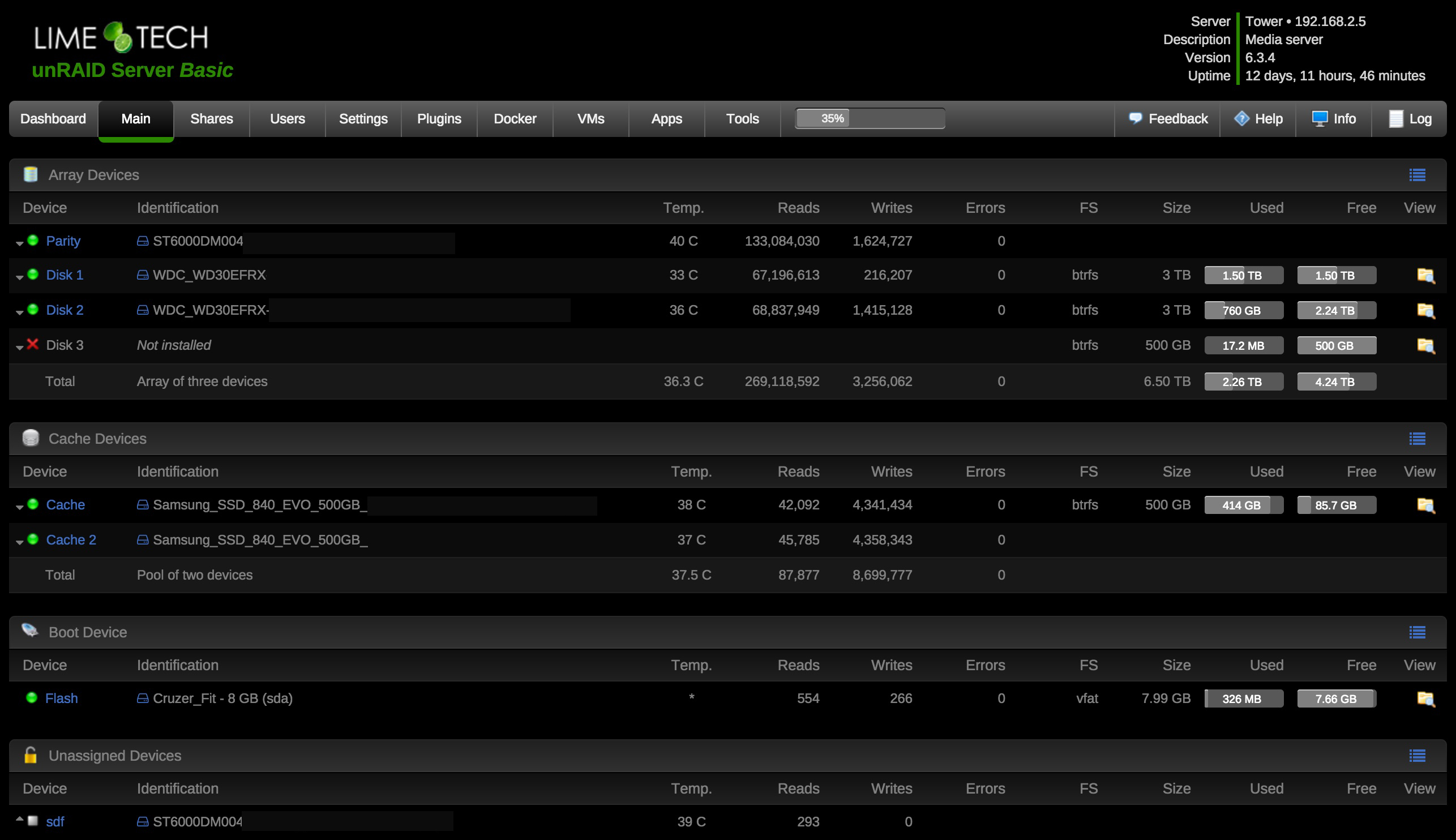

Attached is a screen shot of my array.
I don't want to lose the data. I want to shrink and remove the missing disk.
The wiki information is confusing because it reads like I'm going to lose the data. Does the New Config keep my data or remove it? I had nothing on the disk and parity has been rebuilt daily, but won't work until I remove that disk.

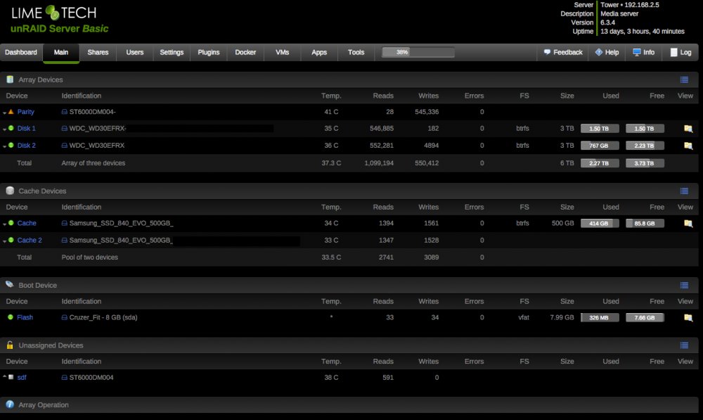

Alright, I took the risk. Followed these instructions to the letter. And SUCCESS!  Attached is how it looks now.
All data is still there. It removed the missing disk and is rebuilding parity. All services are running.
