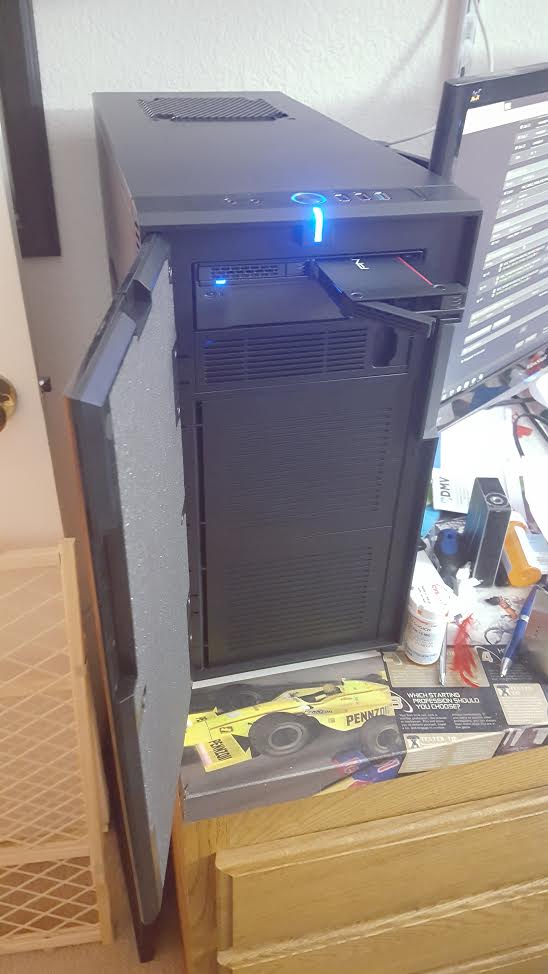

Hi all. I finally got around to pulling the trigger on my first unraid/home server. The goal of this build was to fulfill the following criteria:
  • Run an ungodly amount of dockers
  • 1 linux VM for my databases
  • Hold 10 drives total
  • Plex
  • Redundancy
  • Smallest package possible
Parts list:
Now you might be asking, how are you getting 10 drives in that thing when the case only holds 6? Ah, this is the beauty of the smallest form with most drives. I searched tirelessly to fall upon the case I chose. It can hold 6 drives internally, and with the ICYDOCK hotswap cage, I have my two mirrored cache drives in it. That cage can hold 1 more HDD, along with the 5.25 at the top for a total of 8 full size HDDS + 2SSDs!!!
I am currently in the process of pre-clearing the 3 drives im starting with. 2 drives + 1 parity. Hopefully they go off without issue.
I can officially become the data hoarder I've always dreamed about.
I just wanted to post this completed builds so I could get your comments/thoughts, and also just give reference for anyone trying to accomplish the same goals as I listed above.
The build went absolutely smooth and went off without a hitch.
Thank you all for the wealth of information here on the forums. Couldn't have done it without you!
