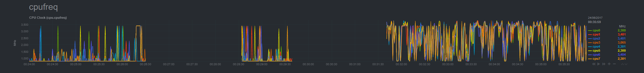

Hi :)
I've updated to -rc6!
Freq still seems to be bouncing all over the place :P (Netdata image attached)
Happy to do anything else to assist, I know it's not the biggest 'issue' in the world, there's so much debate on the internet about acpi / intel_pstate haha!
Not sure if it's an option or not, haven't gotten around to looking through the pstate docs... But I see on the 'Tips and Tweaks' plugin, with pstate left enabled I can change between powersave & performance (both of which work, powersave jumps between 800MHz and max turbo speed (3.4-3.7~GHz) very quickly and when the server is idle. Performance works as expected and pins every core to 3.4GHz + boost when needed.
With intel_pstate=disable ACPI kicks in and I can drop all the way to 800MHz for 80% of the time, with small peaks when containers are doing there thing or the array is accessed, etc.
So 2 things I don't know!
- If the ondemand scheduler exist on the pstate driver?
And
- Which scheduler runs on Ubuntu's pstate driver, presumably powersave? And I'm not sure if Intel have exclusive control? Or whether ubuntu / the kernel guys can (or have) tweaked this :)
