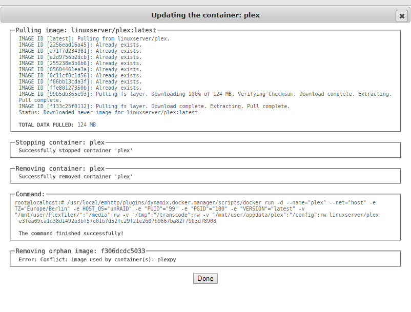

I have two containers names "plex" and "plexpy". They are using the images "linuxserver/plex" and "linuxserver/plexpy".
When I update the "plex" image, I get an error at the end that goes:
Removing orphan image: 88a4edfe4d3a
Error: Conflict: image used by container(s): plexpy
I believe that is due to plexpy having a similar name to plex (and incorrectly matches), because I have no issues removing the orphan plex image through command line or the advanced view of the gui by itself.
My guess is, the same command that is trying to remove the orphan plex image, is also matching the plexpy image that is in use (the image tag above matches the latest plexpy image that is in use, which is not an orphan one) and since the command fails, the orphan plex image is not removed either.
This issue has been going on for many versions and still exists on the latest 6.3.5. I just got determined enough to look into it.
Thanks
The simple solution is to stop both containers first before upgrading.

Here's a screenshot of the problem if it helps further. See attached screenshot. @bonienl @Squid

Orphan images can be deleted by setting the Docker page in Advanced view (button top right) and left-mouse click on the orphan image opens a menu, choose Remove.
99% sure I've got this fixed.  Need to wait for the next Plex update however
