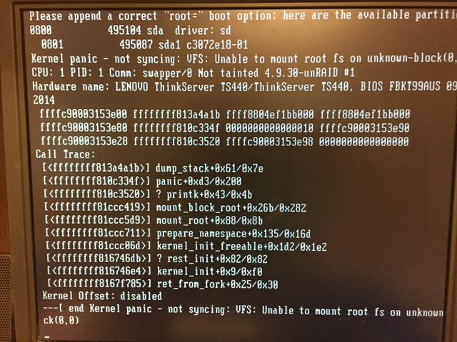

I just updated my Server from 6.3.3 to 6.3.5 and it's failing to ReBoot - after several attempts I can see the following:

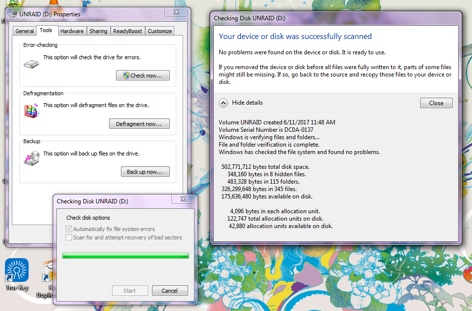

Check the stick for file system errors in a desktop / laptop
Hi Squid,
What am I looking for on my stick?  Sorry for the delay.
Dave
No clue how you do it on a MAC, but windows you go properties on the disk, then check file system.  Only suggestion I have beyond setting up the flash over again.
Thanks, will try that on my Windows computer.
Is it possible to re-download the update from Lime-Tech?  If so does it have to be on the main Server or can I do it on the "Back-Up" Server that's still up but awaiting re-boot to the update.  It offers the opportunity to download latest version on the "Main" screen.
Dave
Apparently no file system errors:

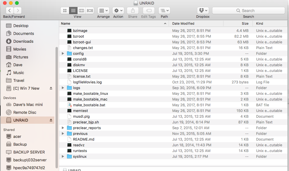

Only suggestion I hAve is to download the zip again from the lt website and copy over all the files starting with bz
Sent from my LG-D852 using Tapatalk
And yeah you can do that to update manually
Thanks, will give that a try ASAP, back in a few!
D
Thanks Squid , that worked!  Not sure why the download had an error doing it through the routine update, but c'est vie!
