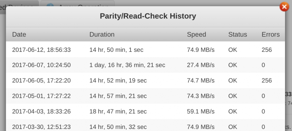

I've been having some issues with my server lately and can't seem to get them straightened out.  Several months ago I had a disk that was disabled and emulated.  I rebuilt my data onto that disk and everything seemed to be okay.  About a week ago, that same disk was once again disabled.  For a second time, I rebuilt the data onto the disk and everything seemed okay.  That thread is located here:
Now the SMART info for that disk is reporting 1806 reallocated sector count.  Current pending sector count is 0.
My plan is to replace the disk.  Before replacing the disk, I decided to manually run a parity check ("Write corrections to parity" was checked).  My parity check reported that it found 256 errors.  About a week ago, my parity check reported the same number of errors (diagnostics from last week's run is in thread linked above).  Diagnostics for today's run is attached to this thread.
Last week's syslog showed quite a few "disk8 write error" messages.  It also showed "recovery thread: Q corrected" messages.
Today's syslog only seems to show "recovery thread: Q corrected" messages.
I'm not sure if this is meaningful in any way.
My UPS reported a power failure in the middle of my parity check.  My server didn't shut down, but I'm not sure if this would have an impact not he results of my parity check.
I'm not really sure how to proceed.
Besides the high reallocated sector count on my disk8, it seems to be behaving normally.
I have so many questions.  I don't even know if they all make sense.
1) Since I ran the parity check with "Write corrections to parity" checked, does that mean that my parity data might now be incorrect?  If the file on my "bad" disk was corrupt, did running a parity check in this way just corrupt my parity?
2) Or rather, is it possible that the failed parity check from June 5th updated my parity with incorrect parity information because it failed to read my "bad" disk, and now my latest parity check (with no disk errors) just corrected it?  Both of these parity checks reported the same number of errors.
3) Is there a way to check the file system on my "bad" disk to see if there are any corrupt files?
4) Is there a way to see what file might be corrupt based on the sector number?  It would be great to know which file might be corrupt.
5) In my parity check from June 5th, I saw a lot of "recovery thread: Q corrected" message.  I assume that means that my parity data was modified.  If my parity was incorrect, shouldn't it have updated both my P and my Q parity?  Why no recovery thread: P corrected" message?  I understand that P might not need correction in all the same places that Q needs correction, but wouldn't I expect at least some P corrected messages?
