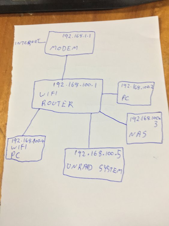

I have an internet modem (which has crap WiFi so i have it turned off) connected to a WiFi router and then everything connected to the WiFi router. i have posted a drawing of how my network is setup.

Did you try to connect to the GUI using            http://192.168.100.5/       ?
EDIT:  If this does not work, try     ping   192.168.100.5     from a command prompt window.
Edited by Frank1940
I tried both options and trying to connect to the GUI timed out and the ping said destination host unreachable.
From a monitor and keyboard connected to your unRAID server, type    diagnostics    on the command line.  That will write the diagnostics file to the   logs    folder on the flash drive.  Upload that file with your next post.
Thanks for your help.
I found out that it was a bad motherboard.
