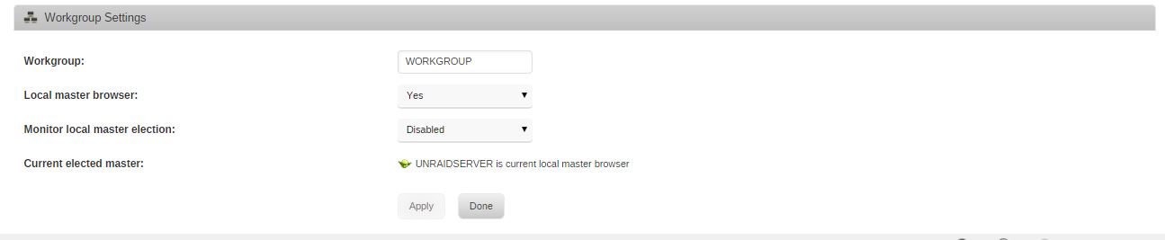

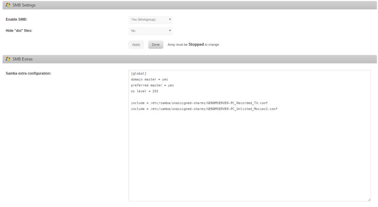

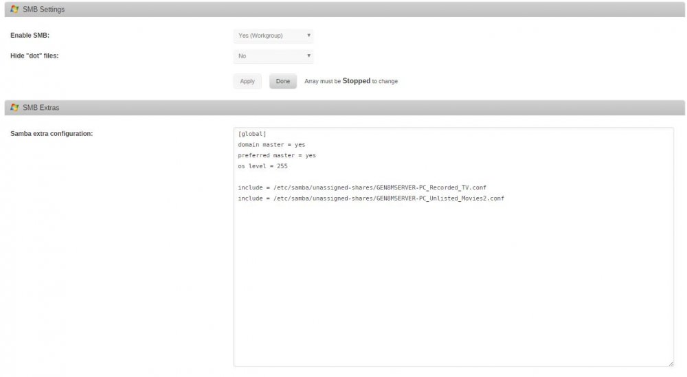

Current elected master: localmaster.pngWORKGROUP is current local master browser (Is this normal? should it say the name of my server instead? I have rebooted (all machines) added the extra lines
[global]
domain master = yes
preferred master = yes
os level = 255
but still nothing?

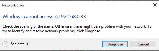

Did you try using the IP?
\\192.168.0.33

On your desktop type on the windows explorer (not the browser) address bar:
\\192.168.0.33
not  //192.168.0.33
You should see all your shares
Edited by johnnie.black
Unfortunately Not :-(
Forward slashes   /     are used in a browser like Firefox or Chrome.  Do you have access to your GUI with   http://192.168.0.33     using your browser?
Edited by Frank1940
Hi, yes  http://192.168.0.33 takes me to my unraid desktop
chrome/edge automatically changes http://192.168.0.33\media to http://192.168.0.33/media as well, thought it was worth a try!

I suspect a Local Master issue.  I would suggest shutting down EVERY computer/device on the network that can possibly use SMB for ten minutes.  Make sure that your unRAID is the Local Master for your Workgroup.   Then restart each computer/device slowly with a couple of minutes between each restart.
Thanks for the advice, I have already tried that several times and even left overnight.  I have Android/Linux/windows 10/7 all cannot connect to my server.  I can confirm that my server is the master since yesterday.. this is really annoying!

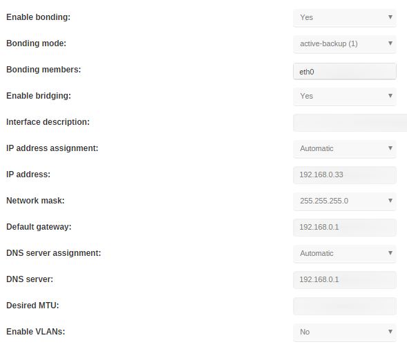

here is a copy of my network.cfg file just in case anyone can see anything awry?
root@UNRAIDSERVER:/boot/config# vi network.cfg
reading network.cfg
# Generated settings:
IFNAME[0]="br0"
BONDNAME[0]="bond0"
BONDING_MIIMON[0]="100"
BRNAME[0]="br0"
BRSTP[0]="no"
BRFD[0]="0"
BONDING_MODE[0]="1"
BONDNICS[0]="eth0"
BRNICS[0]="bond0"
DESCRIPTION[0]=""
USE_DHCP[0]="yes"
DHCP_KEEPRESOLV="no"
MTU[0]=""
SYSNICS="1"
Read network.cfg, 15 lines, 260 chars
I have not changed anything here but does this all look ok?

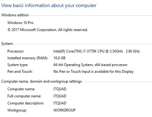

Second, Look at the SMB settings on both the server and the client computers.  Make sure that the workgroup name is IDENTICAL everywhere including capitalization.  I perter to use all Cap's in computer and Workgroup names as that is how Windows has traditionally seen them.  (Linux/UNIX, however, honors capitalization.  Thus, Sam and sam are two different names to Linux/UNIX and one name to Windows.  I have never figured out how SMB/Samba resolves this issue.)  (Think about this problem.  You can create Sam.txt and sam.txt  files in the Linux environment and everything is fine there but your Windows client can only see one of them!)

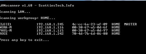

Third, run that lanscan program again on one of your clients.  I just download it again on my win7 client (I can't verify that it works with Win10) and I actually run it by double-clicking on the executable inside of the zip container.  That will give you a picture of what the clients are seeing.   I have attached a screen capture of the output that I see...

2, Image attached for WORKGROUP settings on one of my Windows machines and the unRAID SMB Settings are on the previous post.
3, Lanscan gives the error shown below (it did work a few days ago) it does this same error on all Windows machines but my network is working perfectly for all other devices/machines.

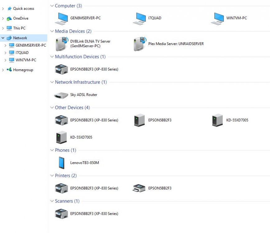

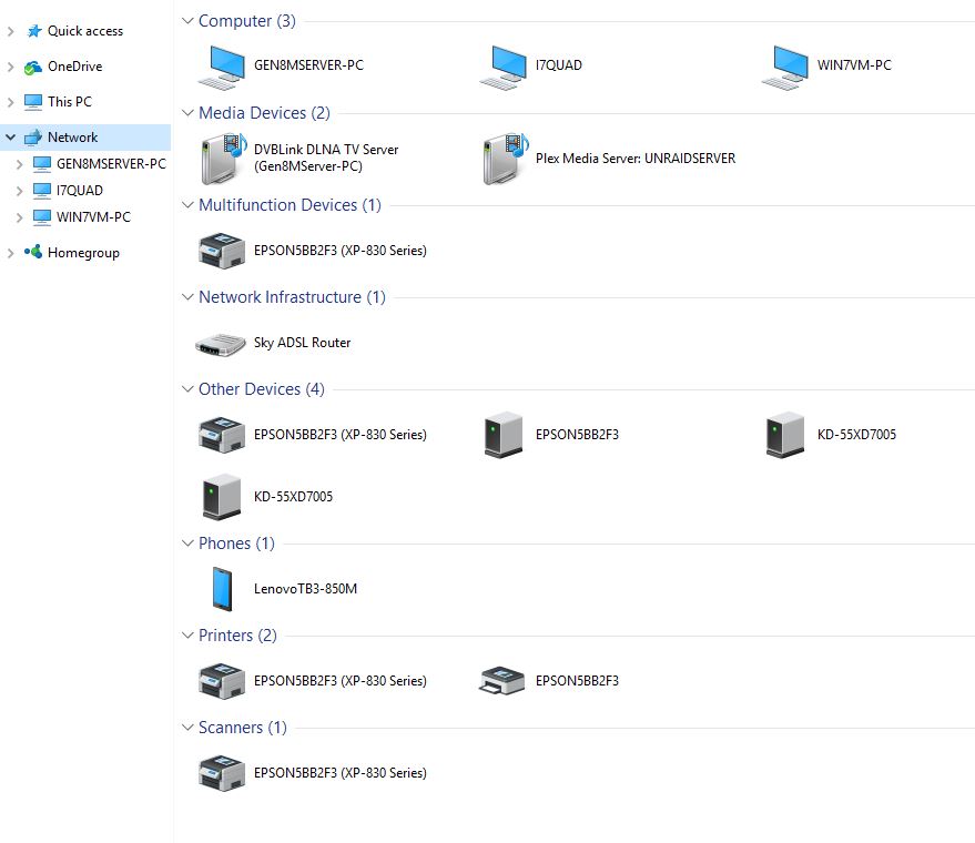

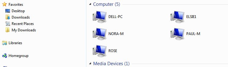

Can you see any other computers from the clients?  (Open up Windows Explorer and click on the Network icon.)  You should be able to see every Computer that is running SMB/samba when you do this.  See screen capture below:
Edited by Frank1940
Hi Frank,
My network is working perfectly, each machine can access each other, all my devices are accessible through WORKGROUP as was my unraid server until I changed the Motherboard/CPU you can even see the plex server on the unraidserver, The biggest clue I think is what I posted on post #3 but I cannot find a way to investigate it "The computer or device you are trying to reach is available, but it doesn’t support what you’re trying to do. This might be a configuration issue or a limitation of the device."
