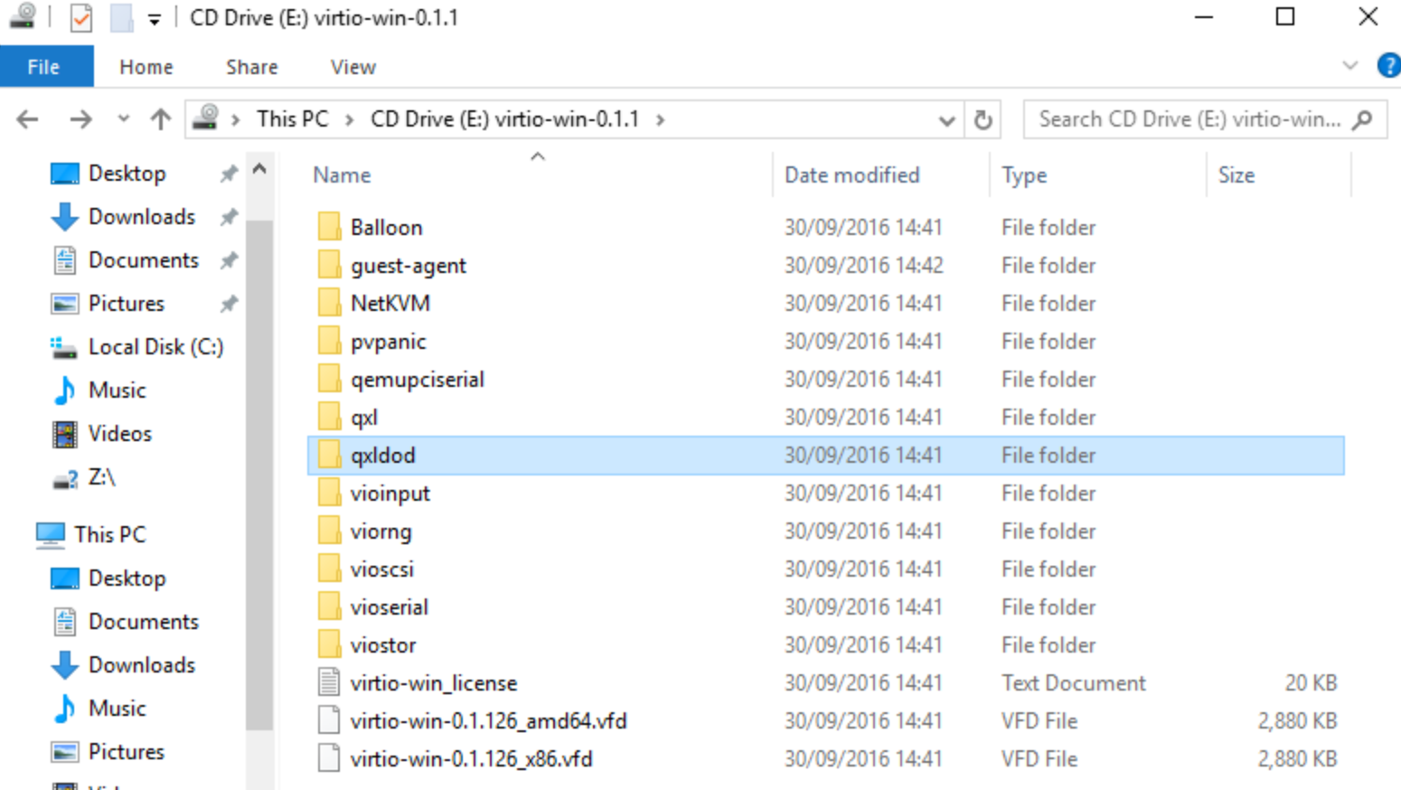

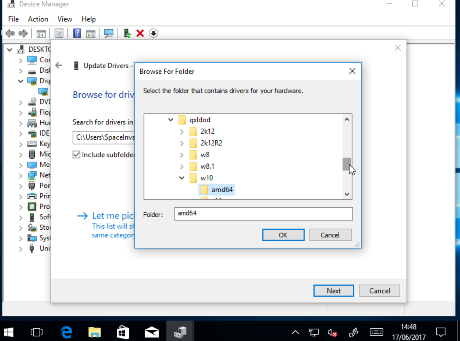

Try manually installing the qxl drivers. It isn't the qxl driver, that you want its the qxldod   (QXL graphics driver for Windows 8 and later)
Maybe it's not pulling the correct driver in on the auto search. I am using 0.1.126
594533e61edb1_ScreenShot2017-06-17at14_47_42.thumb.png.8f20916494eb2a0c3a2e1c40d4368310.png
594533ee3ece0_ScreenShot2017-06-17at14_48_47.thumb.png.c48d37b3508038bdaf85bd25068218b5.png
If this doesn't work I see that maybe you are using an older Win 10 image. I say that because I see in your video the error on the HID Button over Interrupt driver
This was caused apparently by a typo when putting in support more recent ACPI specs. On newer 10 images I think this is fixed as I haven't seen this recently on new 10 VMS I have made. So maybe worth a try on a newer 10 if so.
If you want 4k resolution on qxl it needs 4 bytes per pixel for that res so we need to change the video ram to 64 meg (65536)
So edit the XML to as below
<video>
<model type='qxl' ram='131072' vram='131072' vgamem='65536' heads='1' primary='yes'/>
</video>
