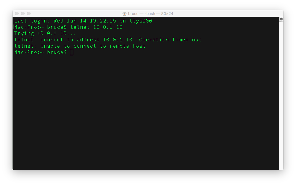

Okay, it's dead again. How do I pull logs/diagnostics off of it if it can't be reached?
See if SSH or the console still work, if yes type diagnostics and they will be saved to your flash drive.
I have no idea what you're talking about. I type the network address into my browser, and the server shows up (or it doesn't). What are these other methods?
Okay, I think I tried at least part of your suggestion, see attached.
So can you ping it at that address?
Do you have a keyboard and monitor attached?
Ping returns 100% packet loss, and I don't have a keyboard and monitor attached. Now, the latest is I can't get the server to respond even after power cycling.
Sounds like a basic hardware issue, not really unraid related.
First thing I would do is hook up a monitor and keyboard, to see what's happening at boot. If you can get the USB boot menu, select memtest and let it run for at least 24 hours and see what happens.

Okay, I agree with you about the Ryzen issue then. Not sure how to edit the C-states exactly, but I have an Asus board, and when I go into the setup, I noticed I had left the power setting on "Cool and Quiet". Can I get away with "Normal"? The other option is "Asus Optimized" but that looks like it just maxes performance. I'm already over-spec'd for a simple file server with a Ryzen 7, so I don't think I need that.
5 hours ago, jonathanm said:
When a USB drive disconnects, the server keeps putting happily along, except it can't save changes, and some items of the webgui don't render properly.  It will NEVER shut down just because the USB is pulled, physically or electronically.
Missed this earlier. Okay, from the symptoms I'm getting, that rules out the USB issue, so THANKS!
I think changing the modes I mentioned before was just the "easy mode" version of changing the c-states settings on my CPU. Currently into hour 3 of a test, and it's looking good. I think you guys may have solved this. I'll give an update at the 24ish hour mark.
