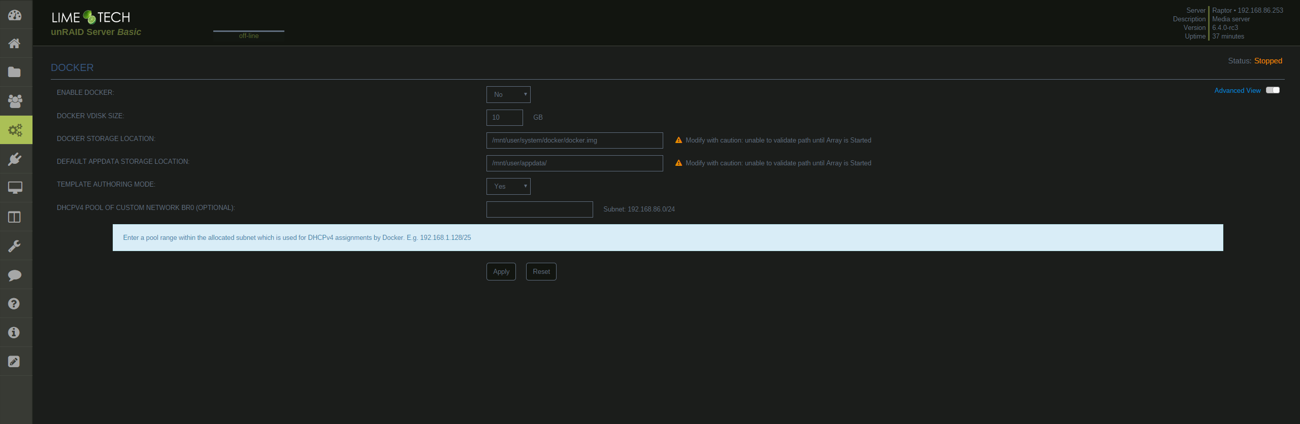

You don't need to create anything yourself. When the docker service is started it will scan the available network interfaces and any interface with an IP address assigned to it (e.g. eth0 or br0) gets added as a custom network to docker.
When you edit a container itself you will see the custom networks added to the regular network choices: Bridge, Host and None. Select a custom network, eg. br0 and another field is made visible to enter an IP address to this container or leave it empty for automatic assignment by the Docker IPAM function.
To avoid address conflicts between your DHCP server (router) and the Docker IPAM function, you can assign an address pool for the latter one. Go to settings -> Docker and stop the service. Once the service is stopped additional settings can be configured.
Ps. Choose Advanced Mode to make all settings visible.

If you don't need dynamic addresses of your containers then just leave the option empty.
Start the docker service and go edit your containers, you will see the network br0 added as a new choice. If this is not visible it is  because you did a manual adding for the same resource. Make sure you remove the manual addition, remove it from docker with "docker network rm macnet100", then restart the docker service.

Yes you need br0, because it tells Docker which custom network to use and allows you to assign the address 192.168.86.252 to your container.
