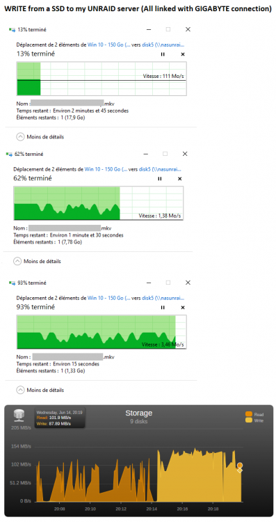

Since a few time, I have speed problems on my UNRAID server.
Before, the speed was very constant : about 110 mo /s during all the transfer with a gigabyte connection.

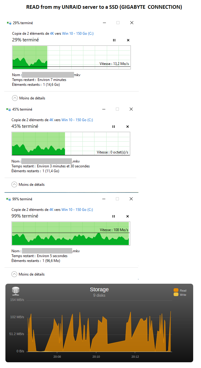

Now, as you can see on the screenshots attached, all transfers speed are very inconstant (read from my unraid server or even write to it). It's very slow to transfer large file.
Moreover, it has an impact using plex, videos stop regularly...
I don't know the reason to that inconstant speeds and I need some help.

Attached, I put also the diagnostics of my UNRAID server.
Do you have any ideas ?
Thanks a lot !!

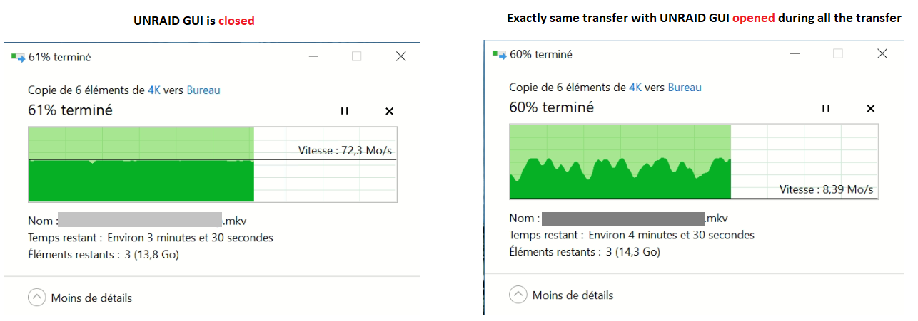

I tried a lot of things, even to install a new GIGABITE PCI CARD. And since, speeds are stable BUT slower (about 75 mo/s but constant).
I notice also another weird thing. If I transfer files and the UNRAID GUI is opened, speeds become unstable again... If I close it, speed become stable again...
I have attached an example.

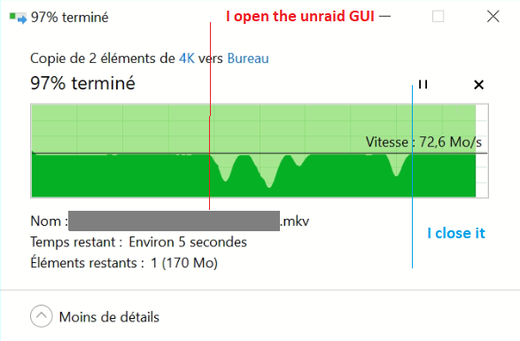

More I test and more I tell me the only problem I have it's when the GUI is opened.
Another test attached.
I will try to do the same tests with my first GIGABITE CARD !
Do you know why speeds are inconstant when GUI is opened ?

I confirm, I tried with my first GIGABITE card and I am stable and the speed is about 110 mo /s.
When I open GUI, exactly same result = inconstant speeds. I don't understand :/
