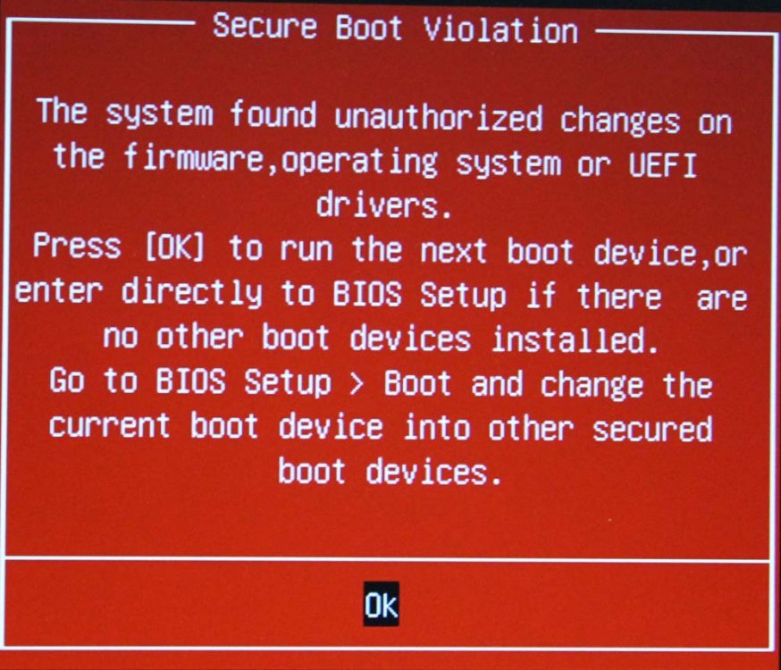

Note: some motherboards may present a strongly worded warning along the lines of "The system found unauthorized changes on the firmware, operating system or UEFI drivers."  In this case look for a "Secure Boot" BIOS setting and change to "Other OS".

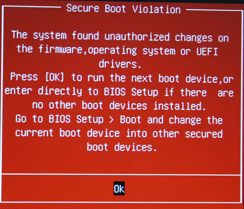

I did the update through the plugin page and when I rebooted, I got a red background message from the BIOS that there was some issue with the booting process due to the
UEFI support and the default choice was 'OK'  (Wish I had taken a photo of it!), picked that default choice, and the boot proceeded normally from that point.  Is this going to happen every time I reboot from now on or it is a one time event?
Can you try rebooting again now to find out?
Stupid on my part and I did it.  Same problem and here is the picture:
EDIT:  This is the my Test Bed server.  Just pushing the Enter key and the boot proceeded normally.  Not a big issue for this server but my Media server is in another part of the house....
Edited by Frank1940
By hitting OK, it proceded to the next boot device (which was probably the non-UEFI version)
So how does one fix it?  (I might be able to figure it out but it would be a help for all of the other follks who are going to be having the same problem!)
UEFI boot from the flash drive worked fine for me.  Maybe you need a bios firmware update?
Maybe by disabling secure boot on your bios?
OK.  I did get it fixed for this server.  I went into the BIOS and went to the 'BOOT' tab of the BIOS.  There were two choices for my boot USB drive.  One was for the UEFI partition on the drive and the other did not have UEFI mentioned in its short description.  The UEFI was the current first choice and so I changed it to the other USB option and that worked.
@Johnnie.black, I didn't try your suggestion as didn't see it until after I had made the change.  But I don't recall having seen an option to disable secure boot but I wasn't looking for it at that point.
I am not sure that the whole issue has been really resolved yet.  I was kind-of hoping that LimeTech might jump in and provide us with some insight as to why the change was made and what changes (or potential changes) might be required as a result of it.
There's a secure boot option for sure on your bios, that's optional when booting uefi, windows supports secure boot, pretty sure unRAID doesn't, hence the error.
I had the same problem booting with a freedos stick created by Rufus into efi until I disabled secure boot
Sent from my LG-D852 using Tapatalk
Yeah, it's not a problem, it just needs to be disabled, maybe add a warning to the release notes that to boot unRAID with uefi secure boot needs to be disable (if the board has that option).
