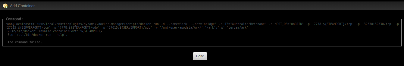

I enabled dockerhub searches in CA, and attempted to add the container with the basic ports described here: https://hub.docker.com/r/turzam/ark/
However regardless of what I put in there, i get an error "/usr/bin/docker: Invalid containerPort: ${STEAMPORT}.".

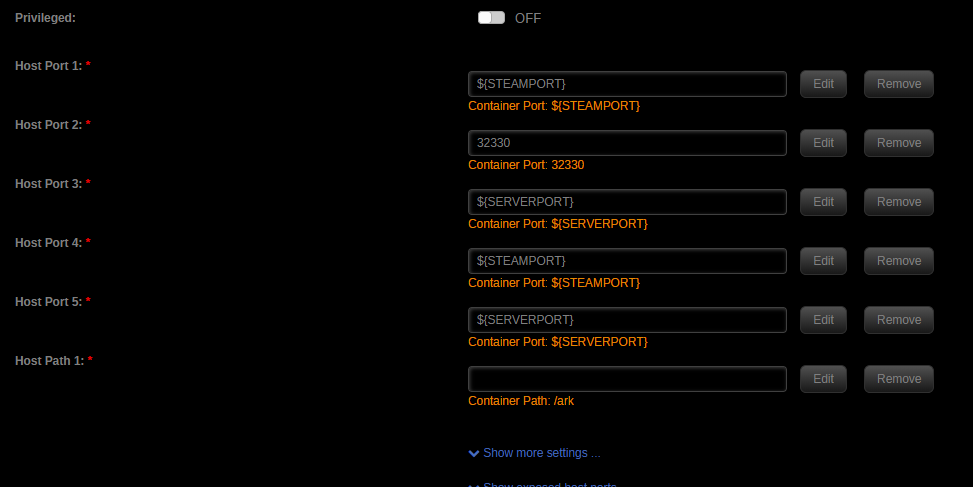

It seems like whatever I put in as the ${STEAMPORT} or ${SERVERPORT} translates into the first part of the code but not the second '27015:${SERVERPORT} and that's what seems to be causing the error.

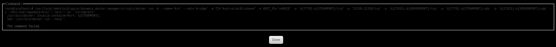

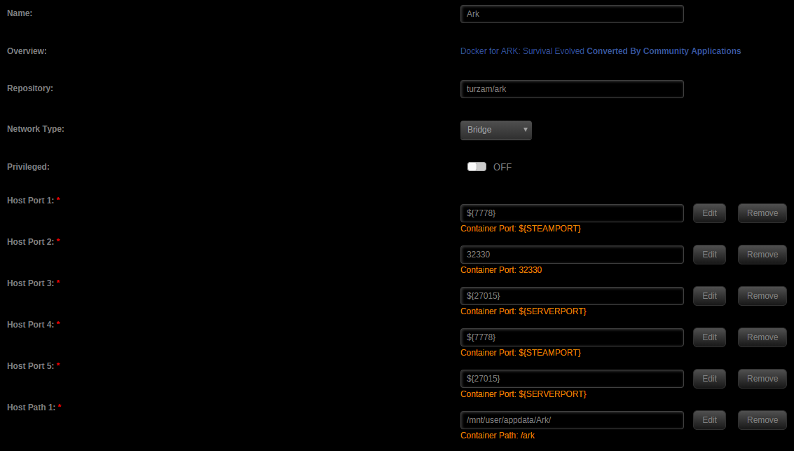

Apologies, I mixed up the previous 2 screenshots. The first image above was the default settings screen. I have tried entering "${27015}", "27015", "{27015}" to no avail.
The below is what I enter in the setting vs the error that is produced.

Click on "Edit" for a particular setting, this will open a second window. Can you show what it looks like?
see below.

Is there an alternate means to install this docker using the command line on the page? Because it seems the script that runs when I get my error message is the same as the below, but with 7778:7778 defined rather than the 7778:${STEAMPORT} which is generated.

You need to delete them, they can't be used.
Ok. That's interesting . The conversion did work correctly and according to design but the dockerfile in its expose lines references environment variables. I'll have to issue an update to ignore things like that.
In the meantime, all those ports that are coming up as ${} delete them completely. And then follow the directions on the docker page on how to set the environment variables (and add them as a variable in the template)
