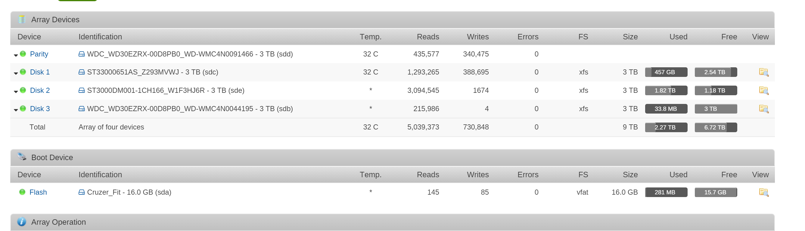

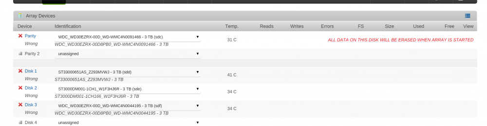

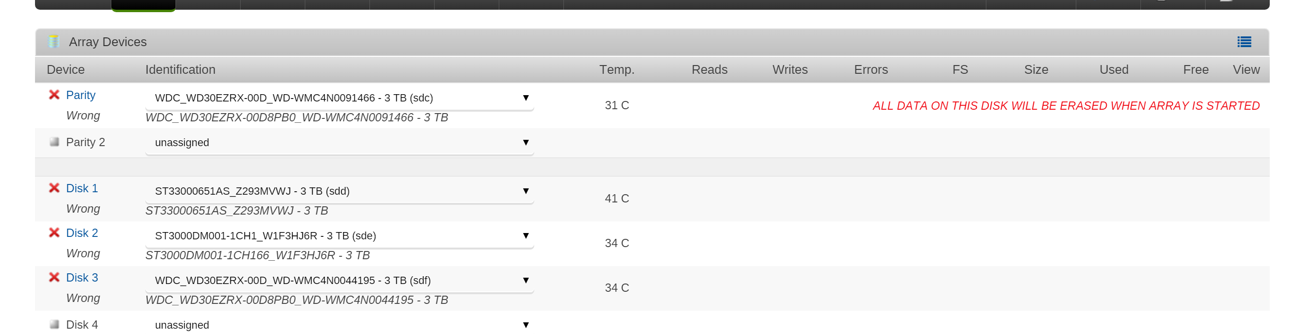

I took a screenshot of the original disks, yet when I try to reassign them, every one comes up as 'Wrong'.
I've tried disabling the PERC H310 BIOS as well with no luck.
Attached are the screenshots and the system log... any advice on how I can get this configured without losing any data or configuration?

Here's the issue, after Step 3 it is not clear what to select, and I was not sure that this procedure would lose my information or retain it.
I also notice that some of the drive strings appear differently as well, if you notice the WD drives are missing an '8PB0' in the drive description and once of the Seagate drives is missing a '66'. But I don't know if that makes a difference, as the other drive that is also being reported as 'Wrong' matches.
