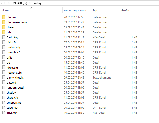

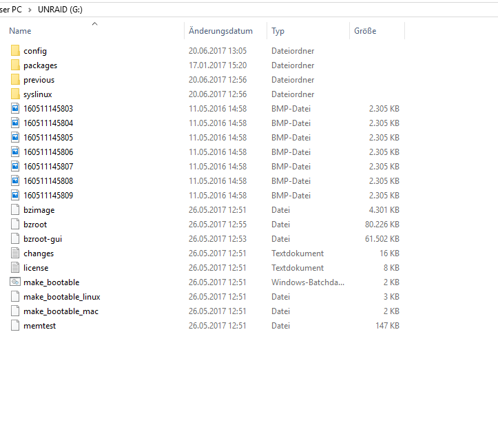

When i put the usb stick in my pc everything lookes normal (key file is there and so on)

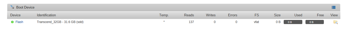

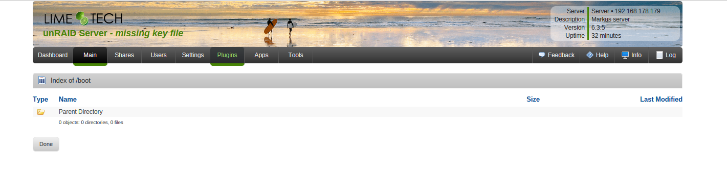

When i open /boot in unraid everything is completly empty
(See attachments)

Put it in your PC and let it checkdisk. If that doesn't fix it try a different USB port.
You my friend are a God!!
I put the usb stick in a 2.0 port instant of the 3.0 port it was before and now everything is like it was before!!!
