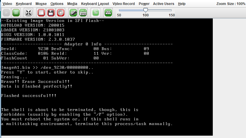

Update the firmware of the Marvell controller to see if it help, they are a know problem on those boards.
Thanks jonnie.black. I've never updated any of the firmware or BIOS on here. I just realized I could have set up BMC. I'm going to work on all this  and update here when I'm finished.
I set up BMC and I've updated 3 things: BIOS, BMC and the Marvell SE 9230 FW.
Link to my mobo website: http://www.asrockrack.com/general/productdetail.asp?Model=C2750D4I#Download
From there I downloaded BMC 00.30.00, BIOS 2.90 and there is a link at the top to Marvell SE 9230 FW. I created a DOS bootable USB and used that to update the FW successfully.

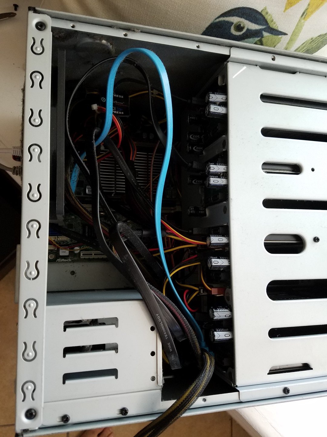

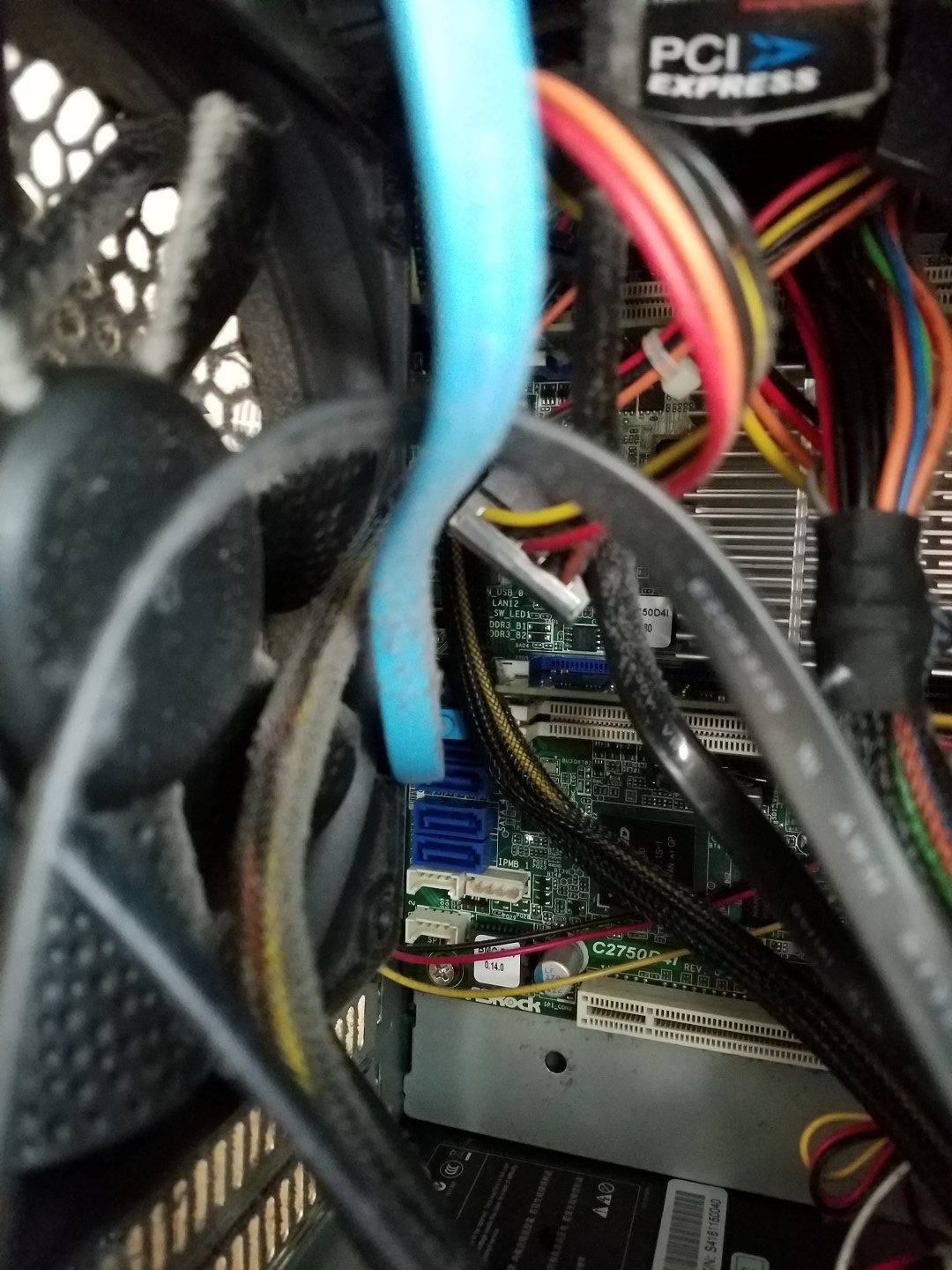

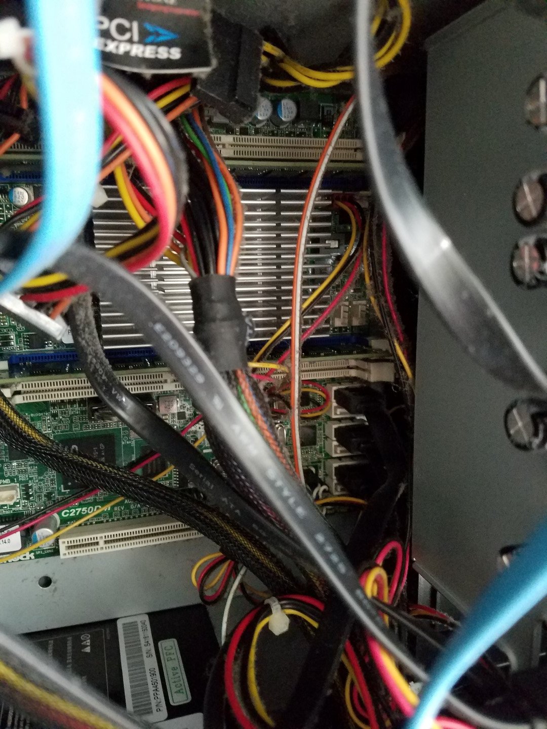

I've attached some pictures of the box and the firmware update.

The blue cable by the exhaust fan is connected to the Intel controller. The 2 closest to the memory are sata3 the other 4 are sata2. The cables on the right by the drive cage are all Marvell. The 2 closest to the memory are the 9172 the bottom 4 are the 9230 and all are sata3.
I noticed from the pictures that you have the oem fans. Your board won't be able to controller those. They will just run at full speed. I also noticed the dust[emoji33]. If you use the magnetic filters you'll have zero. With this case you'll also need to cut a piece of cardboard or plastic that is as long as the drive cage and a little wider than the distance from the motherboard to the drive cage. Otherwise your hard drives will run hot.
