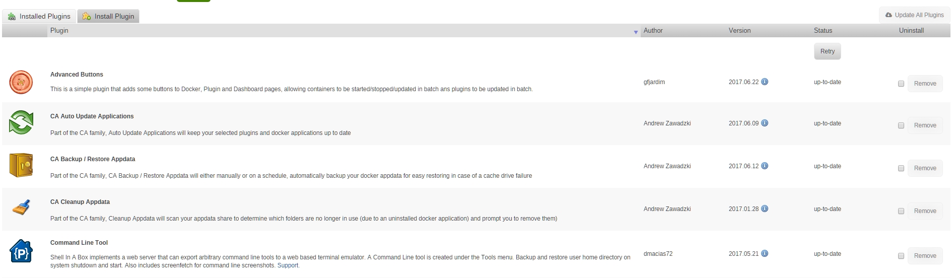

My plugin manager seems to be semi-broken now, after updating and rebooting. I have cleared my browser cache and tried the different themes.
I don't see the new section for OS updates, and the entry for the OS isn't in the list at all
The check for updates button is gone.
I have a mysterious "retry" button at the top of the list.
Update OS (-rc5)
We have changed the way one checks for new unRAID OS releases.  Instead of bundling an "unRAID Server" plugin on the Plugins page, there is a new page on the Tools menu in the About section called 'Update OS'.  Here you can check for a new unRAID OS release as well as switch between the latest release in the stable branch or the next branch.  In addition there is a separate control on the Notification Settings page that configures whether or not to automatically check for updates.
As explained in the release notes, the Update OS is now a separate section. You can find it under Tools -> About.
Also a new schedule is available to check for OS updates independently of plugins, see Settings -> Notifications
The Retry button occurs when internet communication is not present while checking for updated versions of the plugins. Currently not working (a bug :$) but corrected in next version with a more descriptive text to remove the "mystery".
Oh, I saw the notes about the changes to updates and notification changes, and had already updated my notification settings to include the OS updates 4 times a day.
As for the new page, I guess I was expecting the plugin page to have a new tab for OS updates, due to it saying "enhanced plugin manager" with separate sections for both. Thanks for the info, I see it now under tools.
Does the lack of a button for checking for updates mean that it checks every time you access/refresh the page as well?
Thanks guys.
No "Retry" button means everything went well while retrieving the updates.
The updating occurs in the background each time the page is loaded, this ensures that you always look at the latest status of the available plugins.
If you have the ransomware bait plugin installed (and possibly others may be affected), you will always see the Retry button on RC5 due to a bug in unRaid that's preventing it from properly checking updates for that particular plugin.  Already fixed by bonienl for the next release.

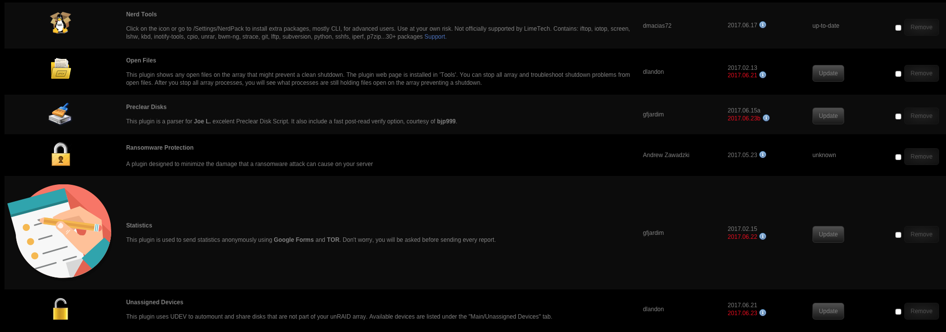

upgrade went fine but now one plugin icon is HUGE. should i report it to the plugin support page?
never mind, just saw it was reported already
