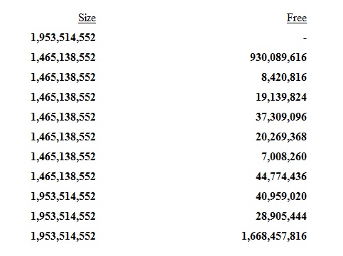

I just thought of something. I heard that the entire unraid slows down if you fill your hard drives up to much due to the filesystem it uses.
Is this to full? Two of my drives have under 10GB free space.

Don't get it... I still can't think of something causing this but unraid, unless all a sudden everything in my system is going faulty.
Notice that many of the disks which are slow to write are near capacity.
Test the interface speed with dd reading from the disk to insure the interface is running at capacity.
i.e. hdparm -tT
When doing these type of tests, make sure all disks are spun up.
Sync the disks.   (sync)
Drop the cache.  (echo 3 > /proc/sys/vm/drop_caches)
Then do your test.
I would do the test directly on the machine with dd first.
Then sync, then drop cache, then over the network.
Real time transfers (over LAN to another computer with known working hard drives).
Disk 1 (Onboard): 45MB/s Avg
Disk 2 (Onboard): 3MB/s Avg          8GB Free
Disk 3 (Onboard): 18MB/s Avg        19GB Free
Disk 4 (Onboard): 6MB/s Avg         37GB Free
Disk 5 (SATA Card 1): 8MB/s Avg     20GB Free
Disk 6 (SATA Card 1): 8MB/s Avg      7GB Free
Disk 7 (SATA Card 1): 47MB/s Avg    44GB Free
Disk 8 (SATA Card 1): 46MB/s Avg    40GB Free
Disk 9 (SATA Card 1): 35MB/s Avg    28GB Free
Disk 10 (SATA Card 1): 50MB/s Avg  1.6TB Free
Example:
-- Writing to a disk in the protected array:
dd if=/dev/zero  bs=1M count=1000  of=/mnt/disk2/test.dd
1048576000 bytes (1.0 GB) copied, 42.68 s, 24.6 MB/s
rm -v /mnt/disk2/test.dd
I usually use 4 to 5 GB to simulate the size of a DVD and use all available memory.
You will notice something on the near capacity disks.
The disk will be very busy during the first part of the write.
Then in a few moments you will see activity on the parity. That is when the real writes start to occur.
This is not a problem with unRAID. It's a by product of near capacity disk on reiserfs.
If you have 5400 drives, this situation is exasperated. It's even worse over a network with samba, because samba connections can time out.
This slow write speed has nothing to do with the parity check/generate speed.

I honestly wish I understood your post more than I do. I have almost 0 knowledge of linux and the advanced things of unRAID.
What I did understand is that I should free up more space on some of my hard drives. It seems I need roughly 40GB free for them, so I will move some of the data off of a few of them down to another hard drive.
No, you do not have to free space up if you do not plan to do time dependent writes.
If you are done filling the drive, then that's it. If you fill it a lil more, it will take time.
Sorry if my notes are skimming above your knowledge level.

Well what I don't understand is why some of those discs are so slow at transfering files to another computer. It makes it impossible for me to transfer things off my server to other computers, which I do regularly.
I freed up 70GB on disc 2, and it still transfers to my main computer at around 8MB/s.. whereas the disk8-10 transfer at 45+MB/s. I simply cannot have speeds that slow for transfers over the network.
If I do a "Disk Speed Test" using unMENU, all my data drives read at 90+MB/s. Transfering files off of a hard drive and onto another computer should only require read speeds on the drive that the data is coming from, so I don't get this.
